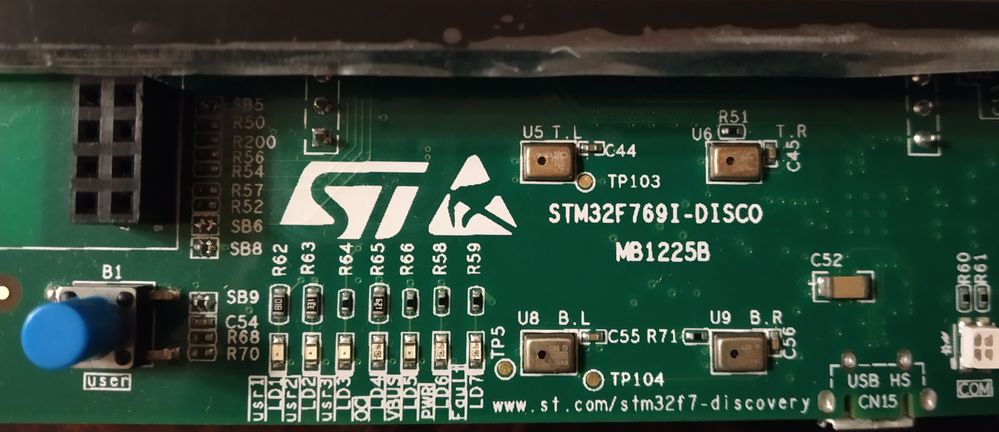

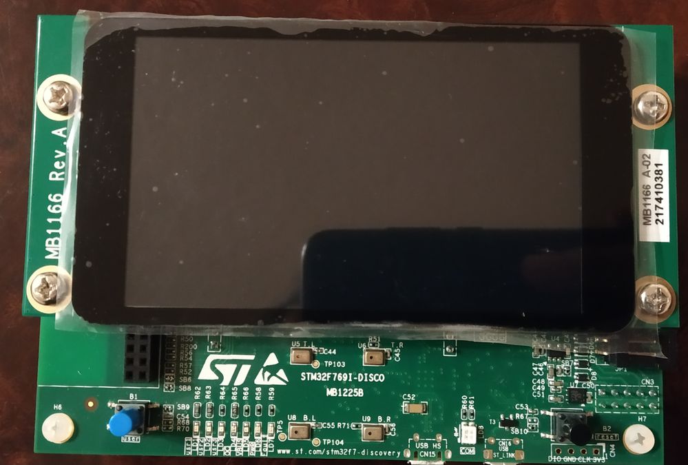

2022-01-26 1:07 AM
I don't know which version is it.
I am sharing pictures with you, maybe helpful.
I see revision A written on LCD but I think it is for LCD not for the ST board.
So as per your comment, it looks like the HelloWorld example with GUI_Delay is working fine for you.
Now, this is really strange why it is not working for me if we have the same boards.
Do you think that somehow my board is damaged? But if that is the case why other demo examples are working fine :|
Anyways thanks for your support.

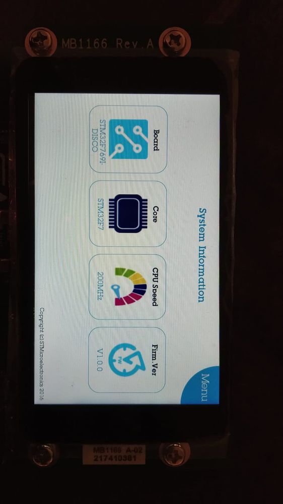

I purchased the board from Amazon.de where the seller was ST. The board comes with a pre-programmed demo and it works fine, and I remember the demo version was V1.0.0, which can be found when we click on "System Information" on the LCD screen.
There is a demo project available named "STemWin" which I think is equivalent to this pre-programmed demo, and when I compiled and programmed this, it works but the display was messy.

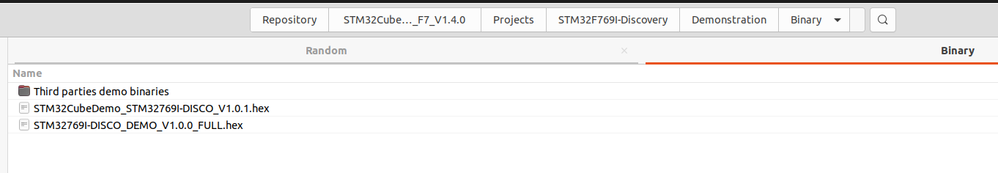

After this, I thought that I will use the binaries directly from the ST website and not by compiling myself.
So, I downloaded various STM32CubeF7 packages, and finally, I found the binaries under the following path. I used the binary STM32769I-DISCO_DEMO_V1.0.0_FULL.hex because it is version 1.0.0 and it works fine. Screenshot below.

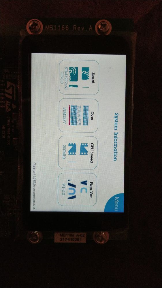

But when I programmed the version STM32CubeDemo_STM32769I-DISCO_V1.0.1.hex, the display was still messy as I have seen when I compiled the demo myself.
I found another version of the demo in the latest version of Repository STM32CubeDemo_STM32769I-DISCO_V1.2.0.hex, and the situation is the same, the display is messy as seen below.
Maybe this can be due to the hardware change, do you know what could be the reason?
