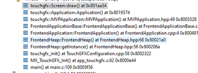

I backup the call stack when crashing as follows. It crash when touchgfx_generic_init() -> FrontendHeap::getInstance(); is called.
HardFault_Handler
<Exception frame>
[_ZN8touchgfx6Screen4drawEv + 0x23]
[_ZN8touchgfx11ApplicationC1Ev + 0x61]
touchgfx::MVPApplication::MVPApplication()
touchgfx::MVPApplication::subobject MVPApplication()
FrontendApplicationBase::FrontendApplicationBase(class Model &, class FrontendHeap &)
FrontendApplicationBase::subobject FrontendApplicationBase(class Model &, class FrontendHeap &)
FrontendApplication::FrontendApplication(class Model &, class FrontendHeap &)
FrontendHeap::FrontendHeap()
class touchgfx::HAL & touchgfx::touchgfx_generic_init<STM32HAL_SPI>(class touchgfx::DMA_Interface &, class touchgfx::LCD &, class touchgfx::TouchController &, signed short, signed short, unsigned short *, unsigned int, unsigned int)
touchgfx::touchgfx_init()
GRAPHICS_Init()

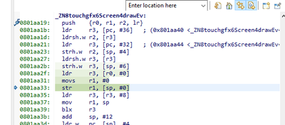

2024-03-30 8:01 AM
Sorry, but now in 2024 this solution doesn't work for me.
I'm trying to develop a custom board touchgfx project with TouchGfx 4.23.0, STM32CubeIDE 1.14.1, STM32CubeMX 6.10.0. MCU is STM32WL5MOCH (Cortex M4).
I've generated the project with CubeMX itself.
MX_CRC_Init() (with __HAL_RCC_CRC_CLK_ENABLE();) is called before MX_TouchGFX_Init().
I have a systematic Hard Fault here:
In _ZN8touchgfx6Screen4drawEV, during instruction str r1, [sp, #0]:

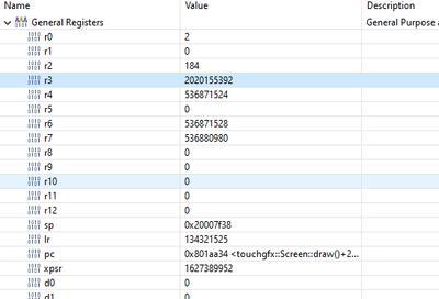

Here are the registers:
What could be the problem?
