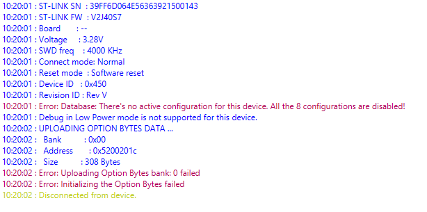

DoneAnd here are the log from STM32CubeProgrammer:
I'm a very beginner workins with STM32 and don't finda lot about these.
Can someone help me please ?

I've found the solution. I used the ST-LINK/V2 Isolated version between the boardand my PC but it needs the non-isolated version of it to works. I took one on a nucleo board and it works weel.
Thanks for your answers @MM..1 !
