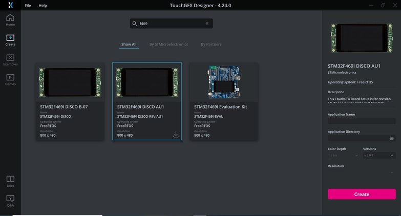

Hello @DerFreaker ,
If you are STM32F469I-Disco, then I suggest using the available TouchGFX Board Setup inside the TouchGFX designer to develop your application since all the required settings are already set for you, so, you can just focus on creating the GUI.
Available TBSs for STM32F469
I hope this helps you, don't hesitate to ask more questions
