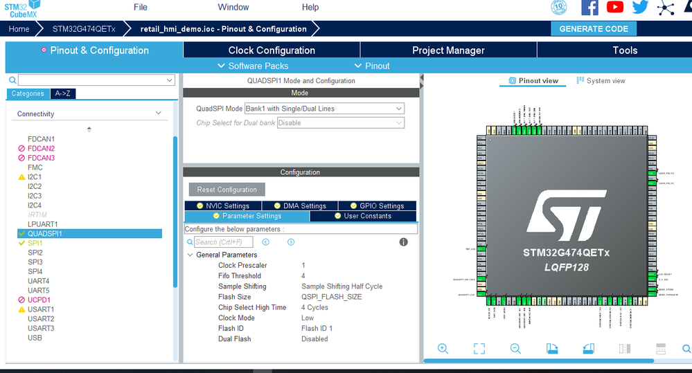

I have been working on implementing external flash driver integration with TouchGFX on STM32G474-eval board, in memory mapped mode.
I have configured the QSPI in Bank 1 with Single/Dual lines. I have attached an image of my CubeMx configuration.
I am getting hard fault while accessing any memory area of external flash. But, while in debug mode, I am able to access the memory address, for example: 0x90000000.

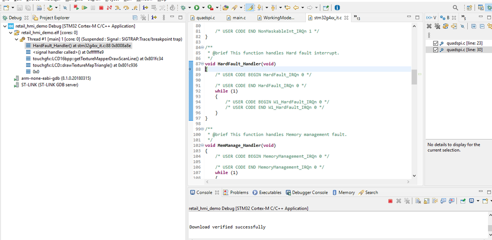

Ok, but that's the Hard Fault Handler, not the site of the fault itself.
You need to go unpack what was happening in the getTextureMapperDrawScanLine()
Why do you erase the memory in the initialization code, won't that break things? ie pointers loading as 0xFFFFFFFF ?

I'm not trying to hijack but I am also dealing with unexpected hard faults and i'm extremely new to arm and ST micros so i'm struggling to understand where to start and documentation when googleing doesn't really align with the STM32IDE environment so sorting out what is what can be tricky.
From your reply I'm guessing that the left pane in the screenshot is the stack trace and that the entry prior to the <signal handler called> is "ALLWAYS" the source of the fault. In the screenshot that would be the getTextureMapperDrawScanLine method?
Is this correct?
2021-02-10 12:50 AM
yes
