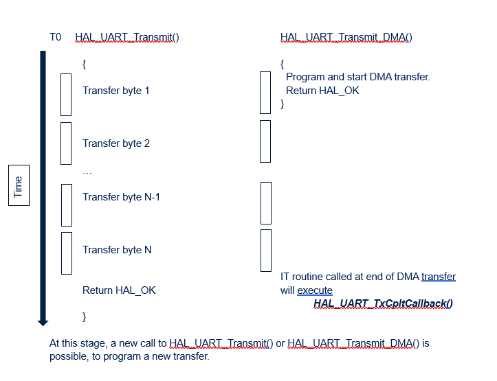

Hi @Krautermann​
I briefly draw a chart to try to explain behavior differences between a blocking transmit API (HAL_UART_Transmit) and non blocking one (HAL_UART_Transmit_DMA). See below.
In case of DMA transfer, the end of transfer is notified thanks to HAL_UART_TxCpltCallback() callback execution. this callback is declared as weak in HAL (empty one), so you could implement your own callback in your code.
For instance setting a flag transmit_ok to TRUE in the callback, and waiting for it to be TRUE in your main could be a basic mechanism for synchronizing transfer end with further actions.
Please make sure to declare your sync variable as volatile, as it will be accessed from both main and IT routines, which could be problematic in some compiler optimizations configurations.
