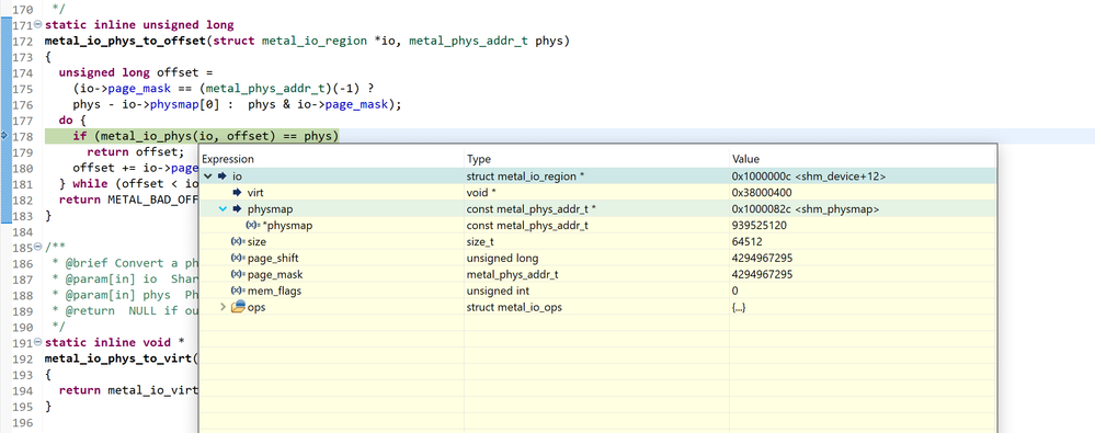

So this is with a TouchGfx Cube v6.7.0 generated project with FW 1.11.0
I have added OpenAmp via Cube and based the code I am adding on the old PingPong example.
The following line fails with -2005 (RPMSG_ERR_BUFF_SIZE):

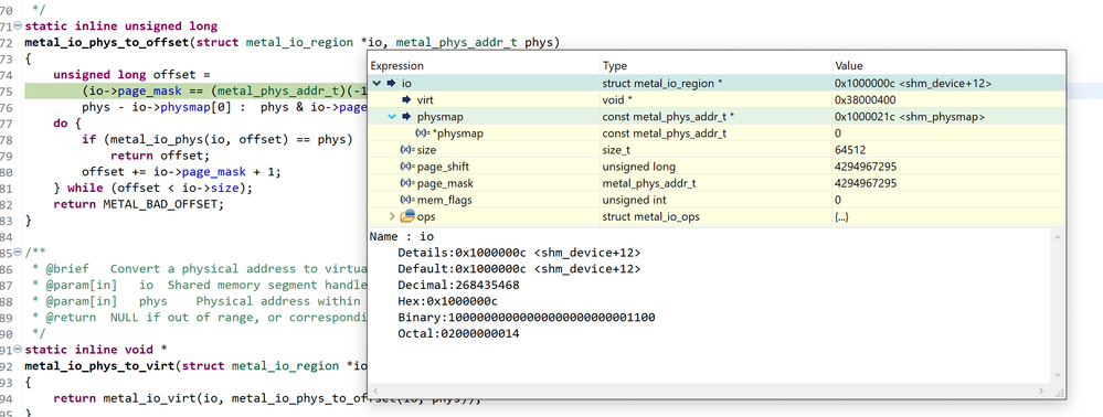

int32_t status = OPENAMP_create_endpoint(&rp_endpoint, RPMSG_SERVICE_NAME, RPMSG_ADDR_ANY, rpmsg_recv_callback, NULL);This is due to the metal_io_region being incorrect, physmap as far as I can see should be 0 but it is 939525120 (0x38000400).
This first image is the values in the working PingPong example:
The second image is in the non working code:
This can be tracked down to OPENAMP_shmem_init() in openamp.c.

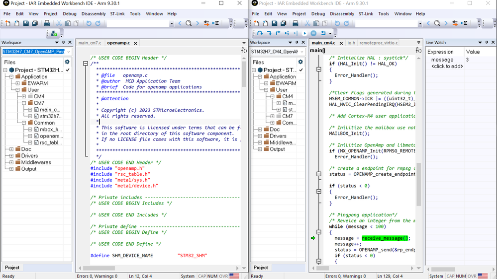

2023-03-30 5:48 AM
2023-03-31 3:34 AM
Hi @ACapo.1,
I tried to execute the example provided with openamp.c from 2023 and it worked.
2023-03-31 3:58 AM
Hi @F.Belaid
Can you please attach the openamp.c 2013 that you have here?
2023-03-31 4:06 AM
2023-03-31 4:15 AM
Thanks @F.Belaid
Looks the same, If I get some time early next week I will try the new openocd stuff with the example as you have to see if there is any difference here.
