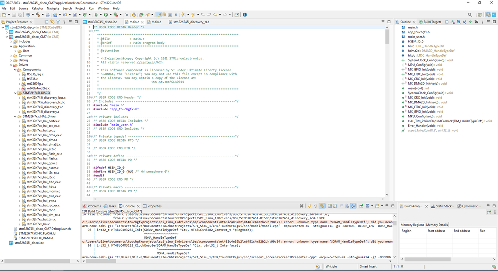

I am using Touchgfx in conjunction with the STM32H745XIH6 board and whenever I create a touchgfx project, the first thing I do is, open the .ioc file in CubeIDE and then disable RTOS from the CubeMX. Then I save and try to compile but I get an error. The issue is because of the CMSIS folder that still exists in the workspace. So then I delete the CMSIS folder and it compiles successfully.

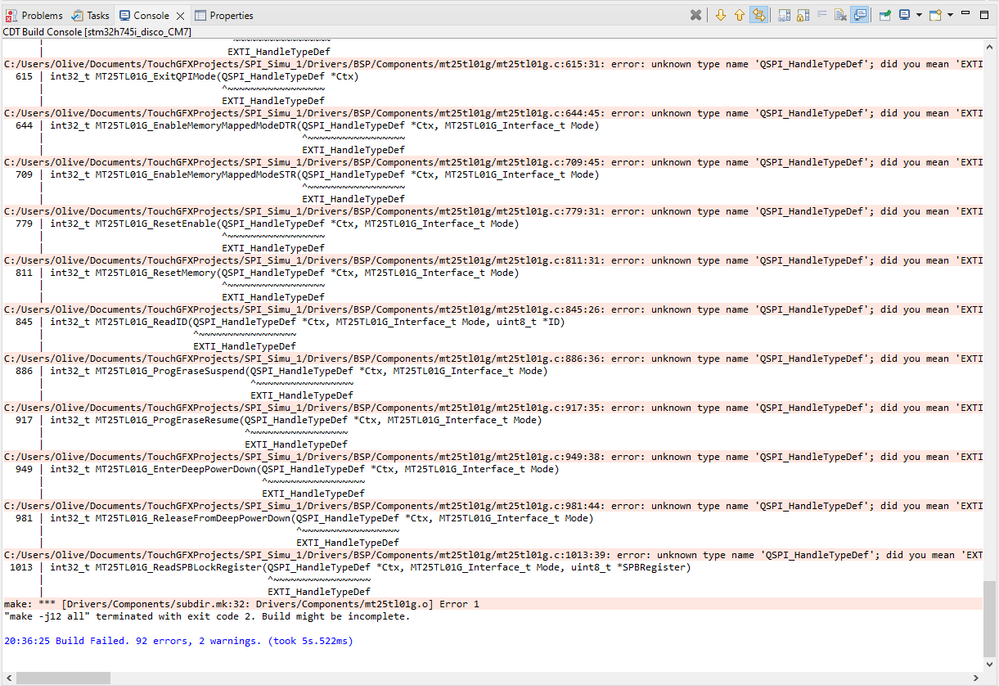

Now I want to also disable QuadSPI and FMC in the CubeMX but when I go back to compiling I get a bunch of errors, like 200 of them. My guess is again it's due to the existence of files that are not needed anymore but I do not know which one to delete! Can someone help with that?

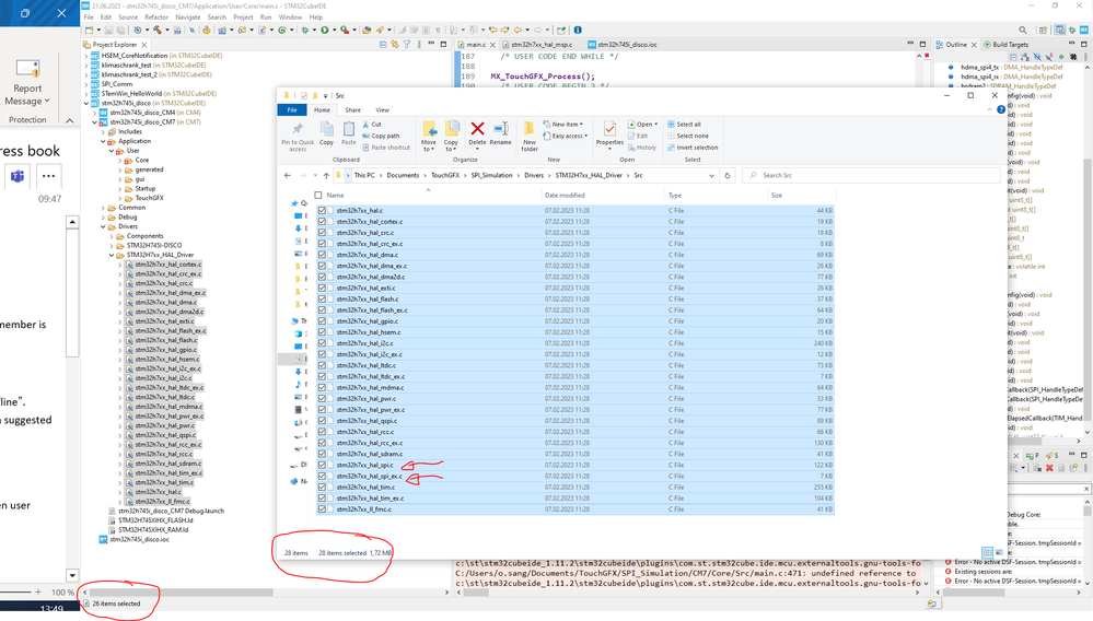

Same goes to UART. If I enable UART in CubeMX, error will occur again while compiling because the corresponding UART files are not found in the STM32H7xx_HAL_Driver folder.
In the file explorer 28 files can be seen, but in project explorer there are only 26, the 2 missing files are the SPI files.
