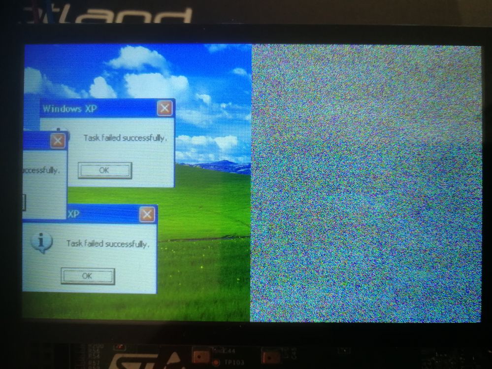

2019-08-20 1:43 AM
Hey, thanks to you it's started working but is only left half of screen displayed.
When I set breakpoint in "waitForVSync" display displayed left side, right side and again left and there is all photo, but without breakpoint it show only this left side.
Could you please help me ?
Regards
Adrian

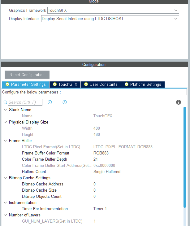

2019-08-20 4:38 AM
Ok I found error.
"BoardConfiguration.cpp"
Check "HW_Init.cpp"
2019-08-20 5:31 AM
I don't know if I am able to help - but it LOOKS like your display is defined as 1/2 it's actual width! Something in that area, maybe every other pixel (looks compressed horizontally). I'd look at the display parameters carefully.
2019-08-20 5:37 AM
Great! That's where I was thinking the issue might be...
2019-08-20 5:38 AM
Yes, width in cubeMx is set to 400 but I can't change this because it is inactive:
