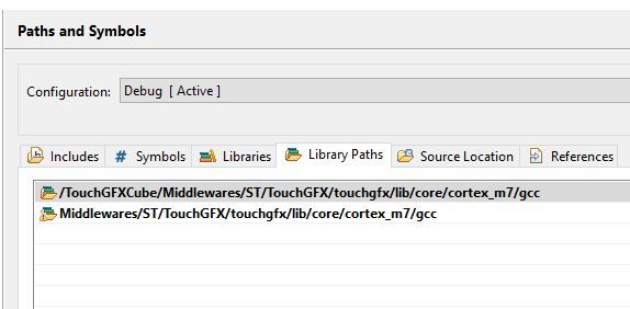

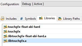

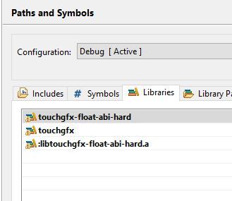

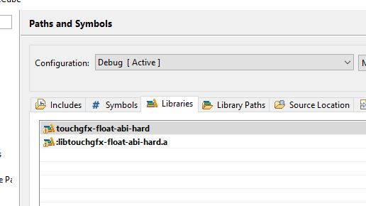

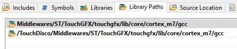

I hope these snips help - here's my working settings (make sure the library file is REALLY there too - mine wasn't until copied over)
I see an extra reference to the same library was generated when I used SMT32CubeMX again as a test!! So there are TWO different styles for finding the libraries...

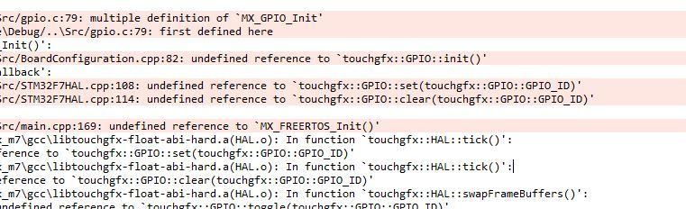

But now I have other problem with GPIO initialization, the compiler returns that there are multiple definitions. Anyone can explain if this initialization is made from TouchGFX library or CubeMX Hal?
"\Debug/..\Src/gpio.c:79: multiple definition of `MX_GPIO_Init'"
"Debug/../Src/BoardConfiguration.cpp:82: undefined reference to `touchgfx::GPIO::init()'"

It appears only one is missing - libtouchgfx.a (which might not be needed?).
Is it actually in the folder??
I tested the build WITHOUT libtouchgfx.a - and it works fine, just REMOVE that library from "Libraries".
(You can also remove the first entry - the second is how STM32CubeMX generates the settings)

@BBenn , if I remove this library the compiler returns the same error. But I think is necessary because below you can see that the compiler call some functions in this library "touchgfx::HAL::tick()" for example.
Here is my situation:
Thanks.
