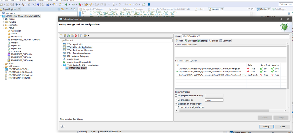

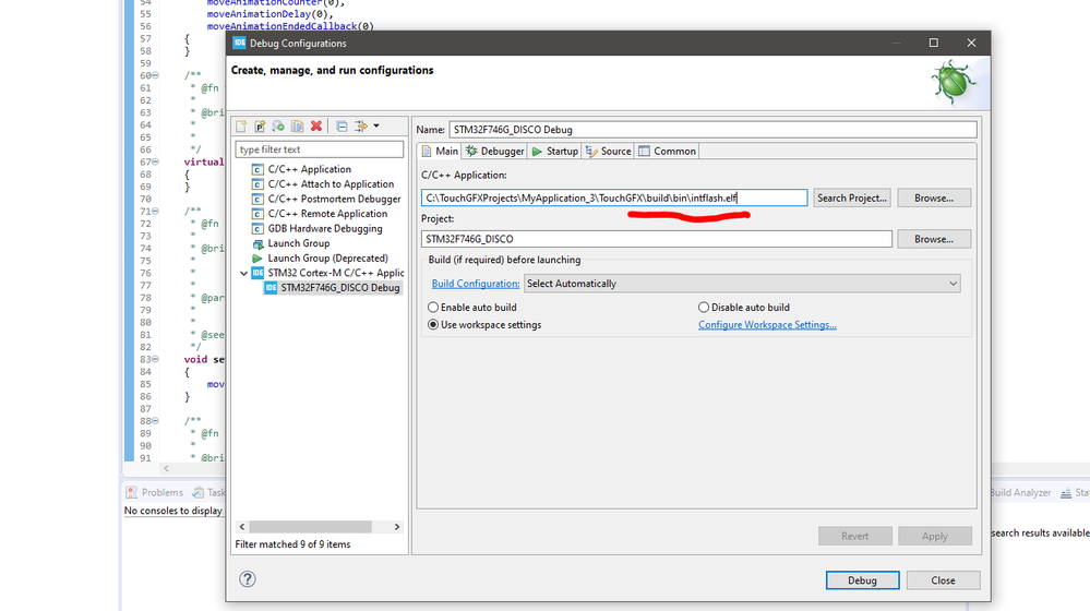

2020-02-09 9:48 AM
I just have added target files without any "dancing with a tambourine".
The order files in first screen is important!!!
