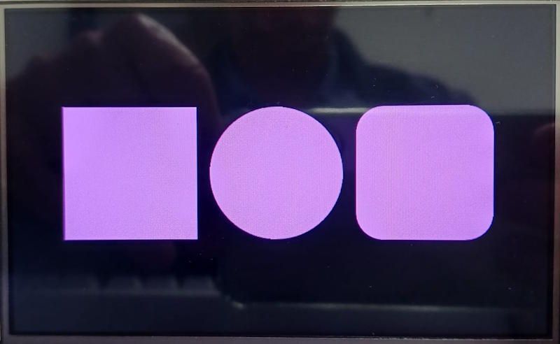

UPDATE:
I found the culprit!
In your code snippet, I noticed the call to function nema_vg_init_stencil_pool().
I did that already in the below function, however BEFORE nema_sys_init()!
Of course, that has to come AFTER nema_sys_init(), so I moved it!
So it now looks like:
void nema_components_init()
  /* Initialize NemaGFX library */
  nema_init();
  nema_reg_write(0xFFC, 0x7E); /* Enable bus error interrupts */
  nema_vg_handle_large_coords(1, 1);
  nema_ext_hold_enable(2);
  nema_ext_hold_irq_enable(2);
  nema_ext_hold_enable(3);
  nema_ext_hold_irq_enable(3);
  nema_sys_init();
  /* Initialize the stencil pool after nema_sys_init() */
  nema_vg_init_stencil_pool(DISPLAY_SIZE_W, DISPLAY_SIZE_H, STENCIL_MEM_POOL_ID);
My STENCIL_MEM_POOL_ID needs to be 1 for some reason, 2 won't work.
But I thinks that's just fine?
