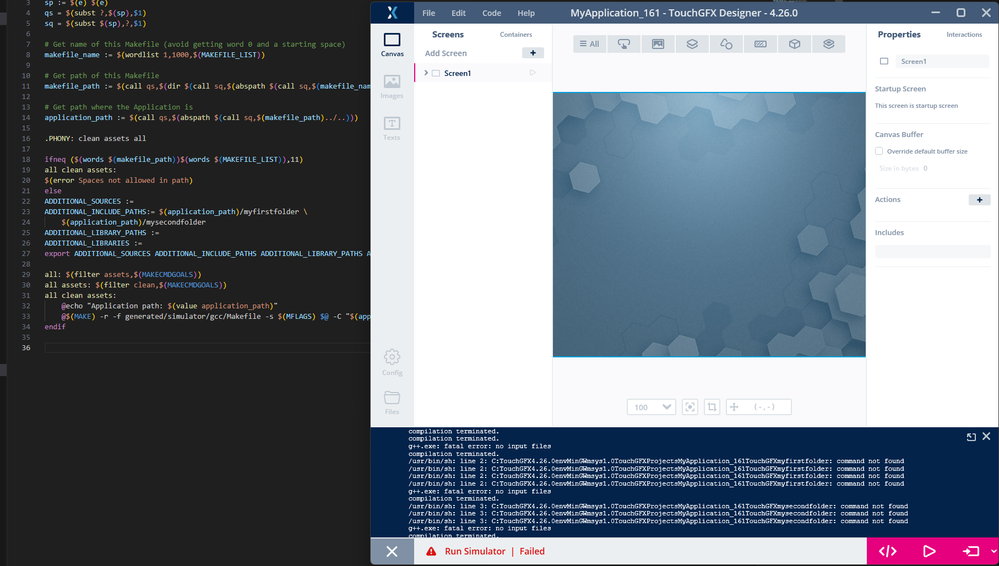

If I do what the OP does, it does not work. Note the error message that shows the path with the slashes stripped out:

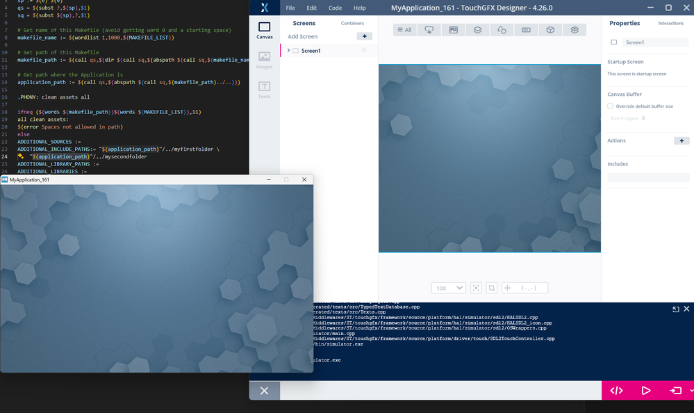

If i put the path in quotes, it works:

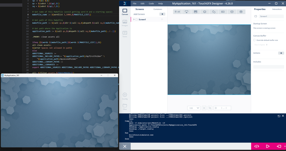

If I moved the folders to the root of the project to have a slash in the path without using a variable (../folder) it also works:

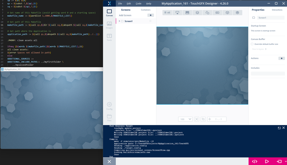

If I use the variable again, it still does not work, but it is enough to put the variable in quotes:
