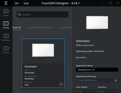

I do not have a board, I run Simulation only. 'Program Run' is therefore not avaialable.
"simply click the Program and Run Target button (bottom right) and not connect your board"
I think this is not user friendly - all I want to do is build application.exe, see if it links. Not interested in running simulation not flashing.

2025-03-05 9:19 AM
I dont need my project to run on HW, I start from Simuator template which is running on only PC. In this case 'Program Run target' is not active, Simulator has no concept of MCU, of course.
Sorry, what you said in 2nd part is something advanced, not my workflow. But thanks, might be useful soon:

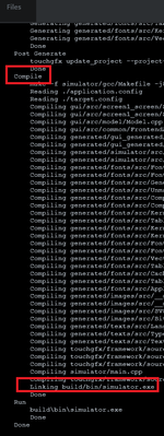

If you run simulator it will compile your files in the GUI folder (where you have your code for your screens and custom containers) so you will see if there are errors or not in these files.

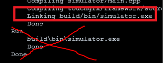

You said "see if it links", when running the simulator, TouchGFX will compile, then link then run the exe, so you will see if it links when you run the simulator :
So in my opinions, you do not even need the Program and Run Target button (I said otherwise previously, sorry).

"TouchGFX will compile, then link then run the exe"
Yes, and what i suggest, is to stop at 'Linking' stage, do not execute 'Run'. Functionality of Ctrl+B in CubeIDE or MSVC.
