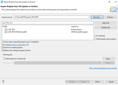

If I import all the folder (as it can be seen in previous image) I can modify .h files but cannot compile because it counts it as an undefined reference, apart from the fact that you cannot compile 2_SPI_TEST file directly, because it does not take into account that it is a project file.

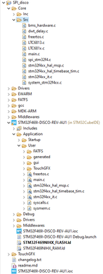

What I mean is that I start designing the GUI part in Touch GFX and then I open the project with Cube.
As this image represents.
But when I create my own files in Core/Src and Inc folders, I include the files correctly, it does not compile this files as the ones already are in those folders. Another thing is that when I create a .c or .h file in another project it appears already with a defined format and in this project I get a blank file, as if it does not recognize it as a project file.

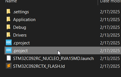

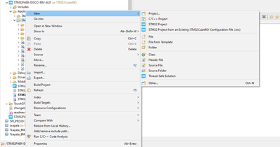

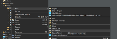

To open your project in STM32CubeIde, can't you just open the .project file in your STM32CubeIDE folder like the picture below shows?
"But when I create my own files in Core/Src and Inc folders"

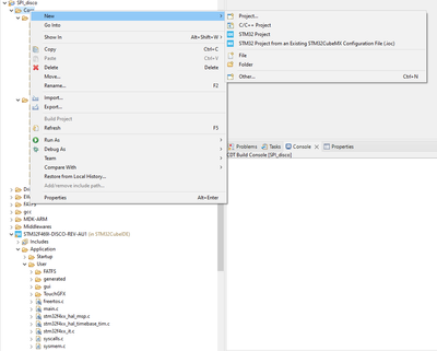

When you create a file, do you do it like the picture below shows?
I assume that you created the function "spi_init_stm32f4".
"undefined reference" error in C typically occurs during the linking stage of the compilation process, it error means that the linker is unable to find the definition of a function so the c file.
Would it be possible that the project is unaware of the c file?

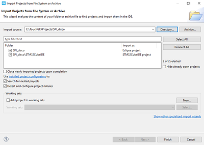

I did it as you showed. I am uploading images for you to see.
"Opened SPI Disco folder"
In STM Disco project file yes but I have not Core Folder nor .h files. It mixes the files and I do not understand why.
2025-02-18 6:33 AM - edited 2025-02-18 6:35 AM
Hello @Enekkk ,

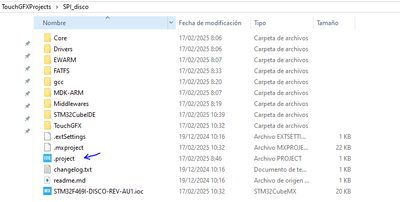

If you double click on the .project file, it directly opens the STM32CubeIDE project, you do not end up on the second screenshot that you share.
To get to the second screenshot, you have to do "Open project from file system" and then you have to select the whole folder created by TouchGFX Designer but you should only select the STM32CubeIDE folder created by TouchGFX Designer which is the same as double clicking on the .project file.
Once you have opened the STM32CubeIDE project, you can create c and h files in the different folders.
However, you cannot create h and c files in the folders that are outside of the STM32CubeIDE project / folder such as the Core folder.
You can add files that are outside of the STM32CubeIDE folder by doing right click, "import", "file system".
Regards,
