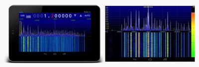

i would like generate my own graph in my firmware, store it in external SDRAM and put it as image on display. I would like to use TouchGFX fonts for X/Y labels, is it possible?
In the other words, i would like create something like this:
with interactions via touchscreen.
So i dont want to use widget dynamic graph. I want to show some pixels stored outside TFT screen buffer. I have 4 banks external SDRAM 4x2MB and im using 16bpp single buffer and single layer. For 800x480@16bpp TFT i need 750kB screen buffer located in bank 0. The periodically computed graph, lets say 400x200@16bbp image will be stored in bank 1 and i want to say to TouchGFX pick this data and copy it into screen buffer in bank 0.
