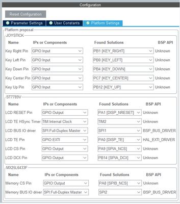

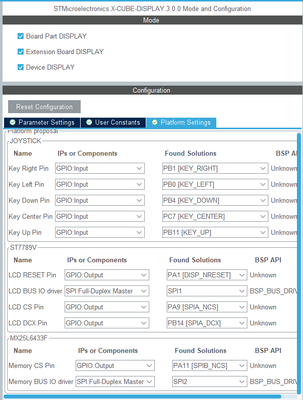

Hi Gaetan. I have a couple of questions regarding the F303RE and the G071. I'm specifically trying to 'match' the F303 to the G071 .ioc files in CubeMX. There are differences in the pinouts of the MCU's, most of which I have managed to resolve however, I notice that in the X-CUBE-DISPLAY V.3.0.0 middleware (in the 'platform settings' tab), the configuration options are different on both despite being the same ST7789V driver as can be seen in the screenshots I have attached below. Can you help me out with this? I would like to know if there is a solution.
The screenshot on the right is from the G071*.ioc file. The LCD_TE and the LCD_TE HSync Timer options are unavailable to the F303RE (on the left).

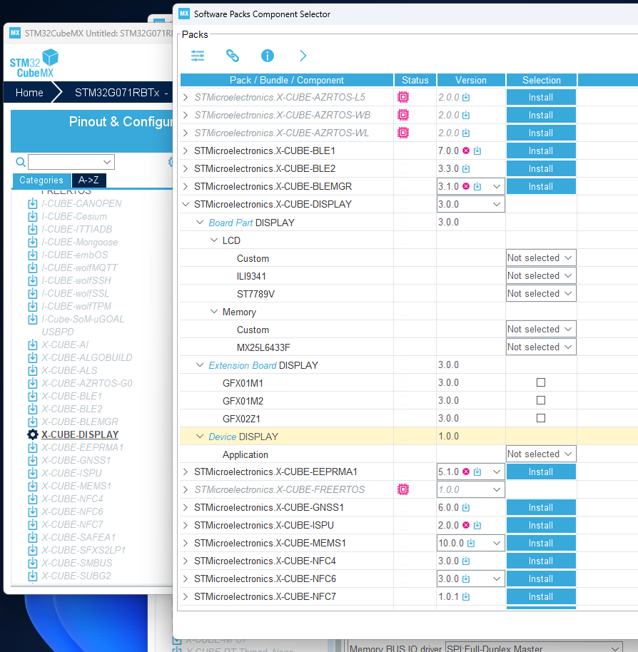

...first, you would need to download and install the X-CUBE-DISPLAY pack via the Help menu in the IDE. Find the pack under 'Manage Embedded Software Packages' menu item. Sorry, I forgot to mention this in my post.

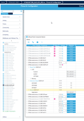

From there, the X-CUBE-DISPLAY is greyed out.
I install it directly from STM32CubeMX.

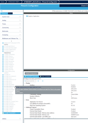

Then it is still greyed out, I look at what is selected and this is what I see :
I do not understand how you managed to have a working example that uses X-CUBE-DISPLAY.
The example created directly from TouchGFX Designer is a working example and it doesn't seem to use X-CUBE-DISPLAY.

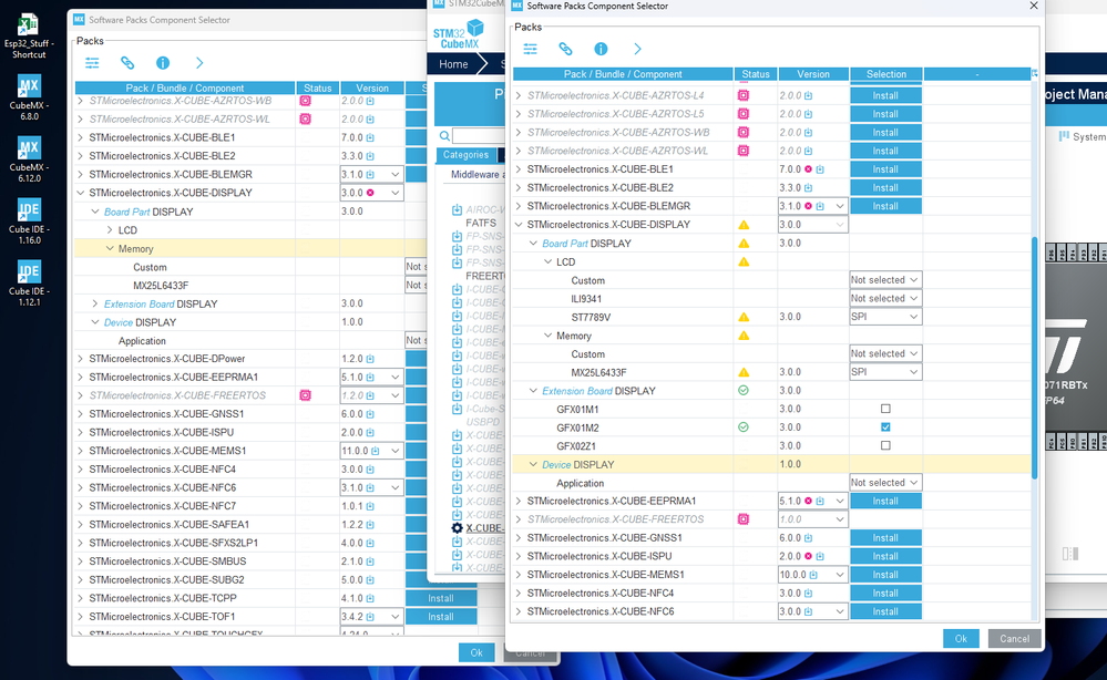

Hi Gaetan.
I attach a screenshot of CubeMX at versions 6.8.0 and 6.12.0 together on my desktop. As you look at it, V6.8.0 is at the right hand side of the screen. V6.12.0 at the left. On the left (v6.12.0), notice the red 'cross' icon in the dropdown box on the X-CUBE-DISPLAY line where as on the right side (v6.8.0) there is no such icon. Essentially, you can not use X-CUBE-DISPLAY V3.0.0 in CubeMX at versions higher than v6.8.0. Version 6.8.0 of CubeMX will allow cofiguration of GFX01M1, GFX01M2 and GFX02Z1 display expansion boards and their appropriate drivers and buses.
The yellow warning triangle appear on the configuration screen on the right (v6.8.0) because as yet, there are no SPI buses enabled in the ioc file. If I were starting from scratch, I would set SPI1 and SPI2 from the 'Connectivity' tab in the ioc to Full Duplex first, prior to setting the X-CUBE-DISPLAY options.
Once you have this configuration, you should be good to go.
The F303RE that I am using for the GFX01M2 display needs to be configured for the diplay as there is no support for it in TouchGFX. As far as I know...and I am no expert by any means, using X-CUBE-DISPLAY via the version of CubeMX I am using is the only means I have found to be able to do this.
