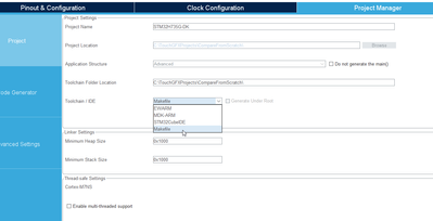

From the png I can read "unsuppoprted toolchain : makefile".
It looks like you select the makefile toolchain in STM32CubeMX when generating code such as below :
If you want to flash your board from Designer, you have to select STM32CubeIDE.

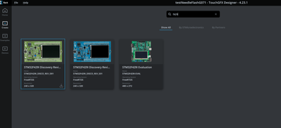

Here are all the files mentioning TouchGFX in their name after generating with your set up :
After opening the template file, it goes up to this (touchgfx project created):
Have you had a loot at the TBS generated when creating a new F429 project from Designer, that could inspire you for your own TBS, maybe you can see some similarities and some differences :
