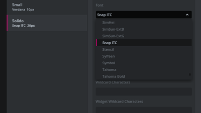

Using Designer 4.25, I copied a font to ./assets/fonts folder but it is not in the list
"Solido Compressed W00 Bold.ttf"

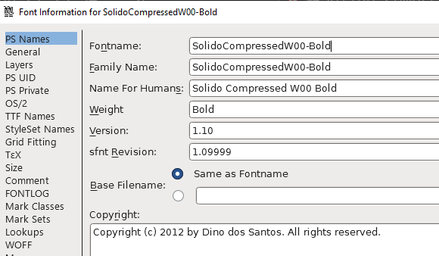

Name displayed by OS is "Solido Compressed W00 Bold" when open in FontForge
Any idea how to make the Designer to recognise the font ?

Hello @ferro,
If you remove the spaces in the font name it works, I informed the team about this issue.
