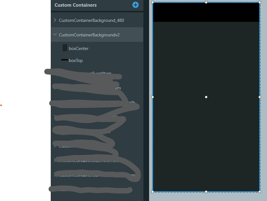

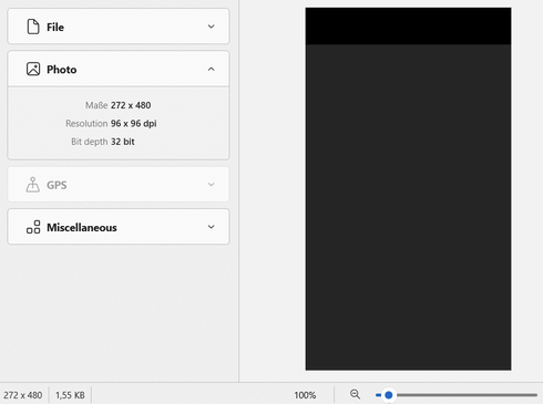

First of all, let me say that I have found the reason of this problem and I could get rid of it, but the point that I don't understand is why?
Let me explain briefly, i am using a container as background for all the screens and this container uses an image with same diemensions of the display in portrait mode. So I removed the image and replaced it with a box.
Like this:
I have used this image before and it caused the flickering problem:
Do you have any idea about this? it's very strange behaviour..

I recall that in earlier versions of the designer you allways needed to start with a picture or a box to fill the entire background on a screen. Otherwise the framebuffer was not blank and could show random pixels and flickering.On the more recent versions this is done automatically behind the scenes on a new screen, but might not be the case for a custom container. I don't know if that could be the reason, but also depends what kind of flickering or pattern you observe.
2023-10-02 12:20 PM
Could be actually this a reason because i am using the version 4.7.0 and the actuell version i think 4.21.
Then I need maybe to migrate my project to the new version.
