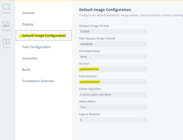

If you want to put PNGs in external flash, you can do specify it from TouchGFX designer here :

Hello @ikendal ,
