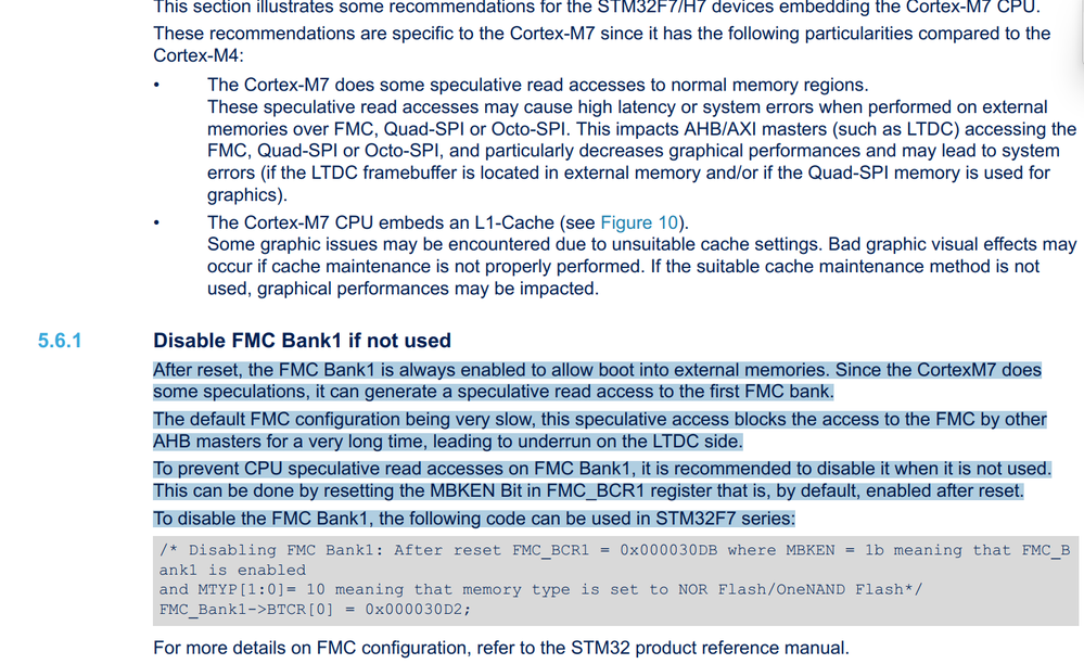

2025-09-18 9:24 AM - edited 2025-09-18 9:24 AM
@CiuppaPT wrote:
Couldn’t this be the cause of our problem? Reference from AN4861.
The first MPU config, I provided to you (the background config) prevents that issue to occur. Moreover, the workaround of that limitation was already implemented in the system_stm32f7xx.c file / line 632:
* Disable the FMC bank1 (enabled after reset).
* This, prevents CPU speculation access on this bank which blocks the use of FMC during
* 24us. During this time the others FMC master (such as LTDC) cannot use it!
FMC_Bank1->BTCR[0] = 0x000030d2;
(void)(tmp);
Now, as I said, try to reorganize your MPU config.
