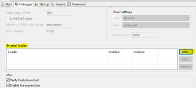

You have also to add properly the M29W128GL to your repository. In CubeIDE, click on the "Run" options and go to the "Debug Configurations" or "Run Configurations" Menu.
Check the external loader used in the" Debugger" tab and select the appropriate version.
