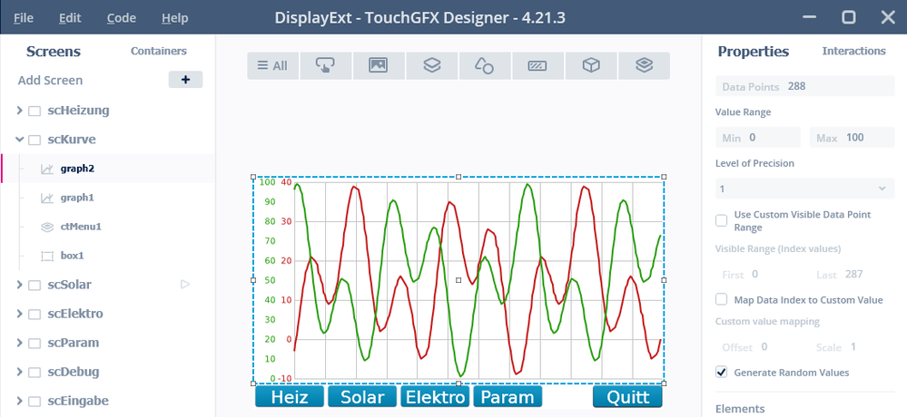

I want have a graph with 2 Y scale, in this case I have use 2 dynamic graph overlaped.
When I run it with the demo board MB1332C (STM32H7B3I-DK), then the graph crashes with a hardfault exception.
The design is like this:

Currently, I have delete "garph2", copy "graph1" and set the parameters again, now it works.
I don't know what is the different as before.

Hello MMüll.6,
I have tried it on an STM32H7B3I-DK board, with 2 dynamic graphs overlapped and it works also.
Good to hear your issue is solved though.
