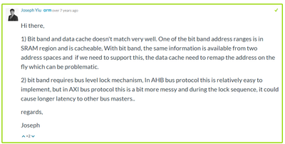

Indeed bit-banding is not available on Cortex-M7. According to ARM community from this post, the reason is the following:
Regarding an available alternative, I think the only solution is to use CMSIS:

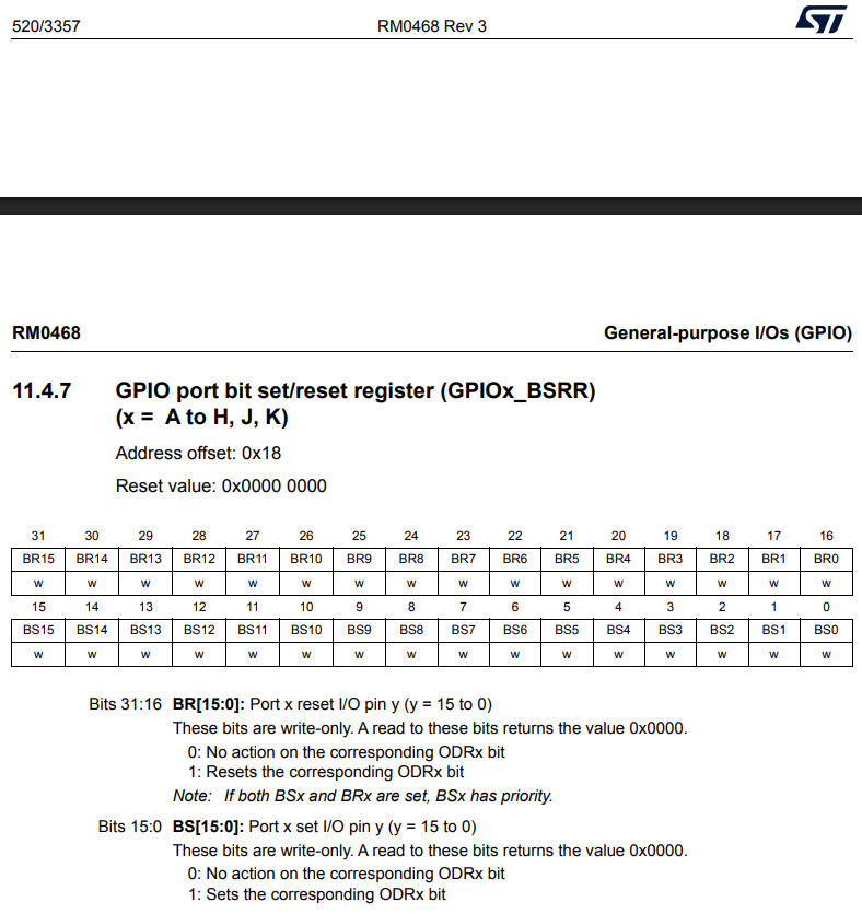

Check if your particular chip has a register (or registers) to give atomic bit manipulation; eg,
That's for STM32H723/733, STM32H725/735 and STM32H730:
https://www.st.com/resource/en/reference_manual/rm0468-stm32h723733-stm32h725735-and-stm32h730-value-line-advanced-armbased-32bit-mcus-stmicroelectronics.pdf#page=521
PS:
You'll probably find that HAL uses this - it certainly does for F0.

As I said, look to see if there is a register for this.
I showed the example of the BSRR register for GPIO ...

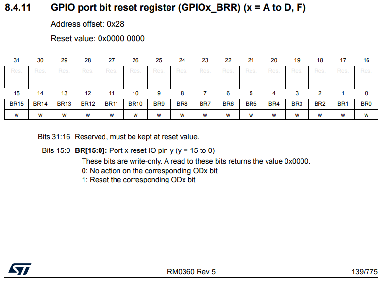

Some processors also have a BRR; eg, STM32F030:
https://www.st.com/resource/en/reference_manual/dm00091010-stm32f030x4x6x8xc-and-stm32f070x6xb-advanced-armbased-32bit-mcus-stmicroelectronics.pdf#page=139
