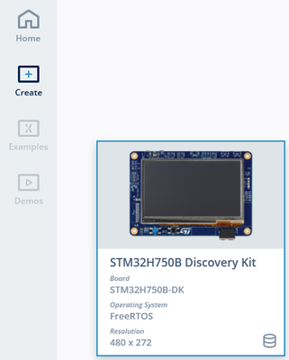

I have been working on the stm32h750b board and when i tried to flash a sample example project named TouchGFX for STM32H750B-DK board with external loader MT25TL01G_STM32H750B-DISCO.stldr in the debug session. I'm experiencing these.
1. the IDE goes not responding
2. after some time it says download verified successfully.
3. But the screen is white, and the board is in reset condition till i press the reset button.
Please help me with how to proceed further. I need to make the GUI program TouchGFX be seen on the board. The example code was from the example selector in the stm32cubeIDE named TouchGFX

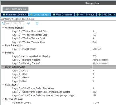

2026-02-11 3:14 AM
Hi John,
I tried the exact procedure which you have mentioned and for the point 5 - i just inserted an image in the GUI and this is the log

2026-02-12 5:28 AM
Hmm, okay that sounds weird then.
Could I get you to try and insert a box instead of an image?
If this does also not work, try changing the default layer color in the LTDC tab in STM32CubeMX, generate code, and flash the board again. This should help to verify throughput to the display. Also set the Window Horizontal Stop to e.g. 240. Otherwise TouchGFX's background box will overwrite the default layer color.
Best regards,
Johan
2026-02-12 9:24 PM - edited 2026-02-12 10:29 PM
Hi John,
I'm attaching the application which I'm working on in a zip file. Can you let me know whether it is working at your end in the same board. This is what I have done. Also I tried to change the window horizontal stop to 240, still the screen is showing white. but when i flash the stm demo hex file given by STM as below
- 'STM32Cube_Demo-STM32H750B-DK-V1.0.0_FULL.hex' :
- an out of the box Demo integrating the StemWin
- TouchGFX demonstration module .
The program is working fine.
1. Create the demo project using touchgfx mentioning the board.
2. then opened the .ioc file using cube MX software, and generated the code and reloaded the Touchgfx application
3. From TouchGFX i generated the code, ran the simulator and then click program the target.
Note: I didn't find any option to goto cube Mx from the Touchgfx designer. I have tried flashing through ST IDE and TouchGFX but the screen is still showing white.
I have attached the file to know the real cause.
