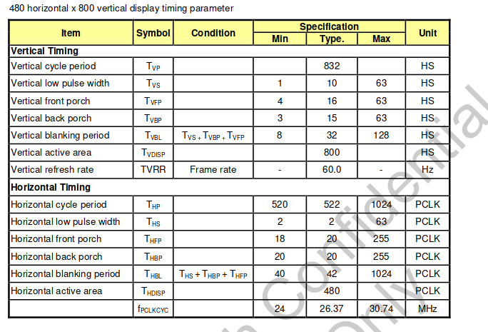

I want to use 800x800x24bit mode. How to understand what's the point to use dsi txclkex and dsi line byte frequency? and how it is correlate with ltdc frequency? in display controller dataheet i have the next description for frame rate
how can i calculate pixel timings for Horizontal Back Porch and Horizontal Front Porch? is it must be based on ltdc frequency?

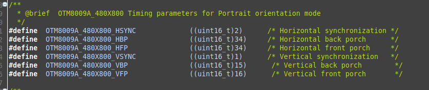

i got example from 429i-disco and datasheet for OTM8009A
and i see HBP = 34, HFP=34 in example, it is not equals to datasheet.
but i cannot understand why? LcdClk = 27429 kHz in example , i checked it in cubemx settings. laneByteClk_kHz = 62500; /* 500 MHz / 8 = 62.5 MHz = 62500 kHz */
2019-10-12 12:20 PM
The datasheet gives a range of acceptable values. You need to hit the 24-30.72 MHz number at the bottom for the display to be happy.
ie 832 x 522 x 60 = 26058240
The STM32 has other constraining factors, related to your PLL clock, and the integer multipliers/dividers, etc which limit what specific numbers you can hit.
Often if you work the math backward you'll get nominally 60 Hz refresh +/- a small error.
62.5 MHz is the delivery rate for 8-bit bytes to hit the 500 Mbps lane speed limit of the DSI (250 MHz clock on the wire, with DDR, such that data clocks on both clock edges). You have to get the data off the chip at least as fast as you're generating it, up to the limit of the bus. You aren't required to max it out, which is why the 435 Mbps was quoted in your top post.
Why not start with the 800 x 800 display you're actually targeting? The 2 lane DSI giving 1 Gbps is going to constrain your refresh rate, and why the part data sheet quotes 720p @ 30Hz
