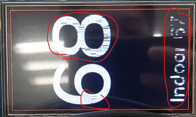

1) Text broken
I found that when the B screen transitions to the A screen, the Big Text contains text broken during transition and is recoverable.
CPU frequency = 280MHz (recoverable) (00:00:07, with 0.25 speed)
video link: https://drive.google.com/file/d/1CLOdeWr4uZ_r9ffi9f0Zoa8mLxGHqC14/view?usp=sharing
Contains Black pixels
CPU frequency = 160MHz (irrecoverable)
video link: https://drive.google.com/file/d/1GZGT-tRYJ5CKWq-NUqbRcbQ5Ftn7lW1n/view?usp=drive_link
Text pixels always missing after transition
2) Animation Storage
According to the instructions, I should set a full-screen size buffer for the animation storage. However, I set the half-buffer since out of RAM resources.
(00:00:03)

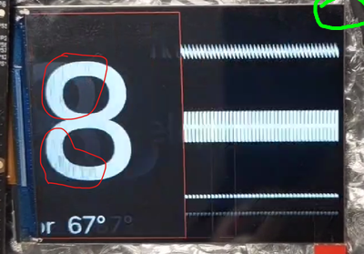

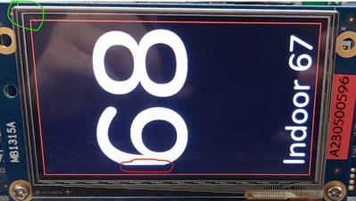

The Text broken issue persists when using STM32H7B3LI-DK with
Result: Green circle should be (0,0), Red circle = Text broken
Video Link : https://drive.google.com/file/d/1FAWcwHx9w8S6NeeVPPbVY8C7fTd5gpfd/view?usp=drive_link
(00:00:07 - 00:00:08)
