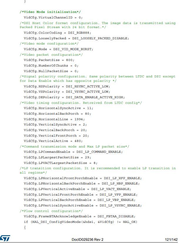

Hello @MM..1 ,
I recommend you to have a look to AN4860 Application note about DSI Host on STM32F469/479, STM32F7x8/x9 and STM32L4R9/S9 MCUs, which describes the DSI Host interface on STM32 microcontrollers and provides practical examples on how to configure the DSI Host depending on the operating mode.
Please follow the instructions in the section 6 to configure the DSI Host in different operating modes
Hope this helps you.
