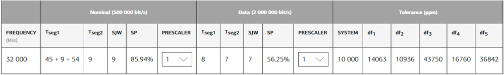

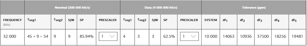

I’ve generated two set of parameters:

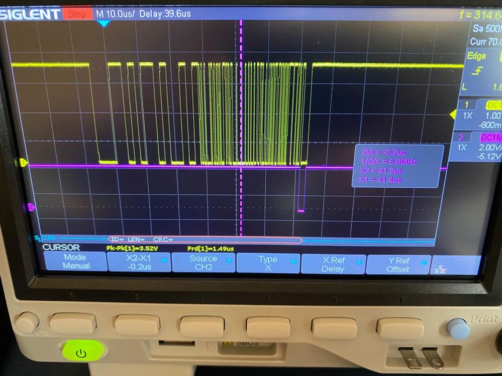

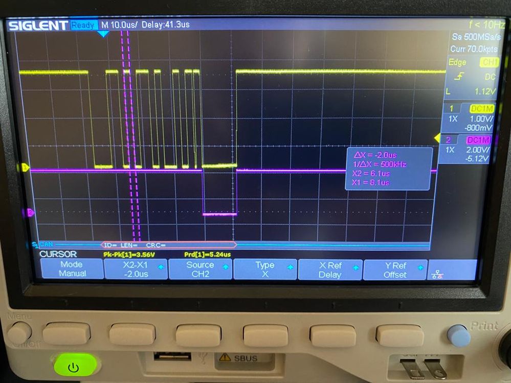

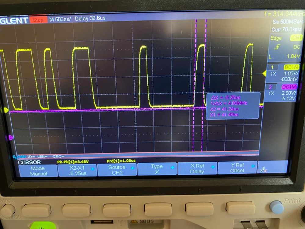

In the second one (where the bitrate is 4Mbit/s) with the transmitter in normal mode, the receiver node doesn’t receive anything. Switching the transmitter to external loopback, the receiver node receives all the data, as seen in the following images:
4Mbit normal mode
4Mbit External loopback mode:
4Mbit bit timing
All of the oscope images are taken on the receiver side on PC4 and PC5 pins.
At 2Mbits everything works as intended. Changing from 2 to 3 or 4 Mbits in normal mode the transmitting board stops transmitting data after arbitration. Switching to external loopback, all the data arrives on the receiver node.
