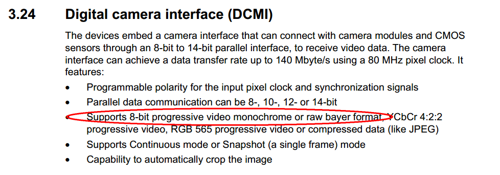

in datasheet, it support Raw 8.

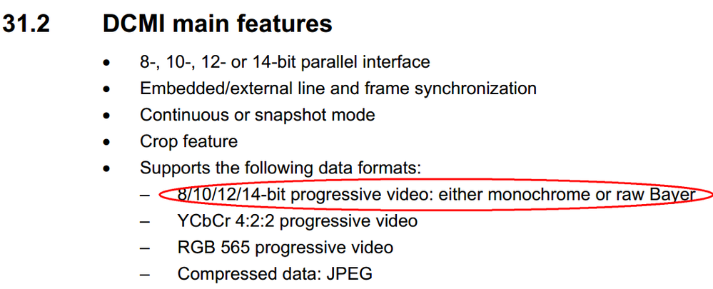

in Reference manual(RM0433), it support raw 8/10/12/14 bit.

Hello @wwang.2 ,
The Reference Manual is correct.
It Supports: – 8/10/12/14-bit progressive video: either monochrome or raw B.
I have raised the DS typo to our team for fix.
