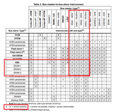

From the reference manual / table 3:
So you can do transfers from/to SRAM1/SRAM2/SRAM3 <-> FMC. you cannot do that transfer to from DTCM/ITCM. You need MDMA for that.
BDMA could not do that kind of transfer.

Please see RM0433: bus matrix Figure 1 (pg. 105) and 22.5.  Your external SDRAM likely is connected thru the FMC.
Look for information about DMA controllers that can connect FMC and other memories.
