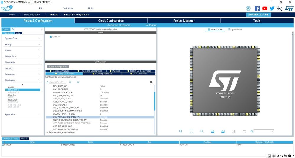

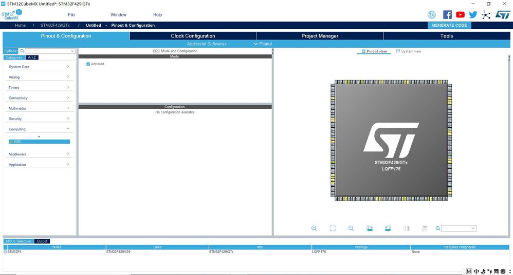

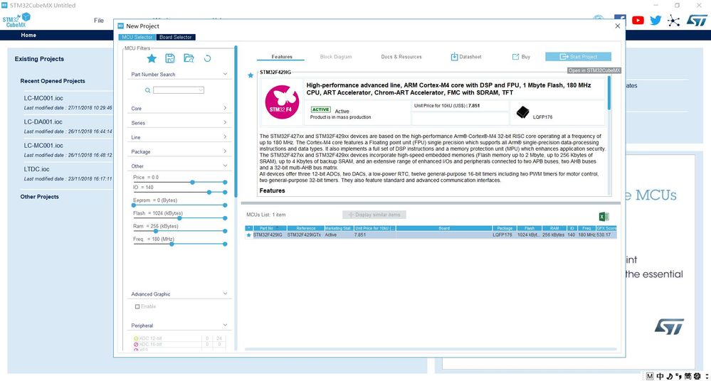

1 Start a new project with STM32F429IGTx.

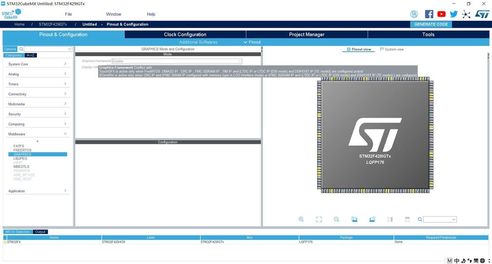

2 Check the conditions that need to be enabled.
3 Enabled FreeRTOS and Enabled Config parameters - USE_APPLICATION_TASK_TAG.

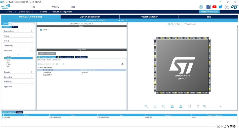

4 Activated DMA2D and configure Parameter Settings.
5 Activated CRC.

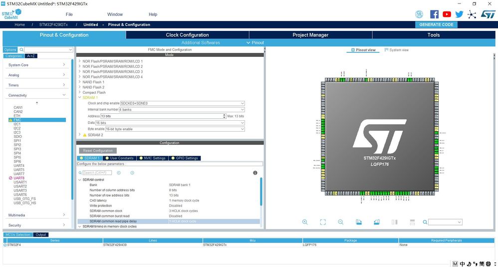

6 Turn on FMC - SDRAM1, and configure settings base on my SDRAM Chip.

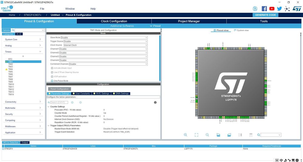

7 Turn on TIM1 and leave the settings by default.

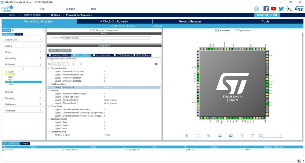

8 Turn on LTDC and configure layer 0 - pixel format to RGB565. Leave Parameter Settings by default.

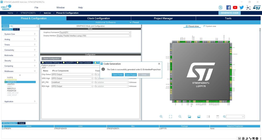

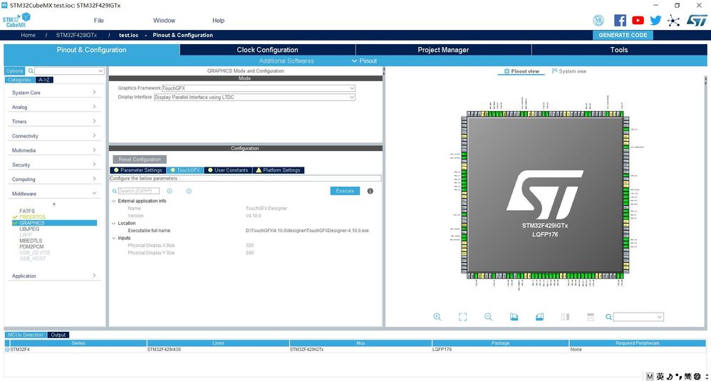

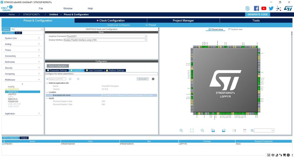

9 Select TouchGFX as the Graphics Framework. Select LTDC as the Display Interface. Select the path of TouchGFX Designer 4.10.0 .

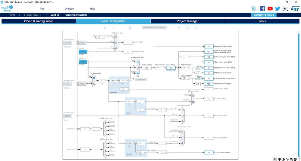

10 Manage the clock configuration.

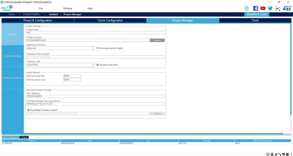

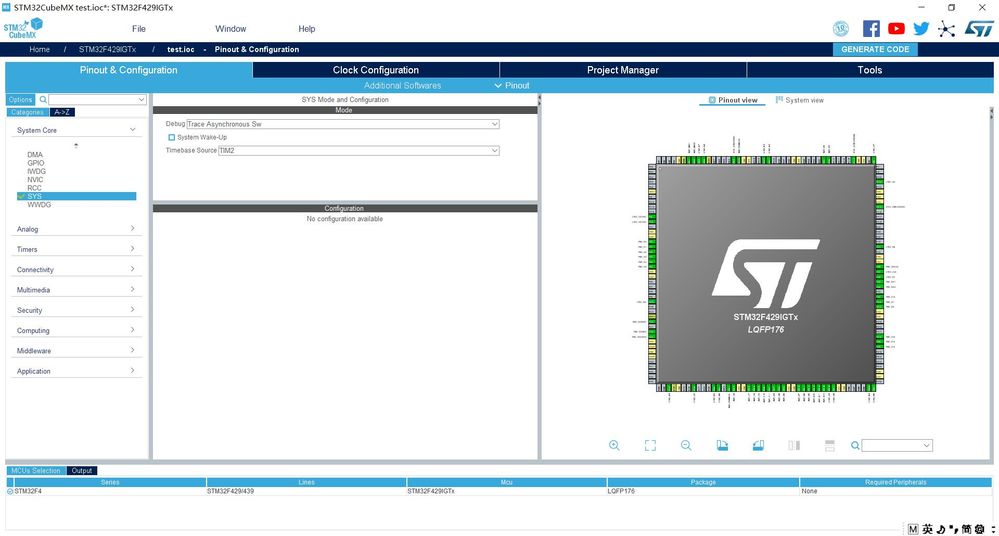

11 Enter a project name and select TrueSTUDIO as the Toolchain / IDE. Leave other settings in Project Manager by default.
12 Set the debug type and Timebase Source in SYS.

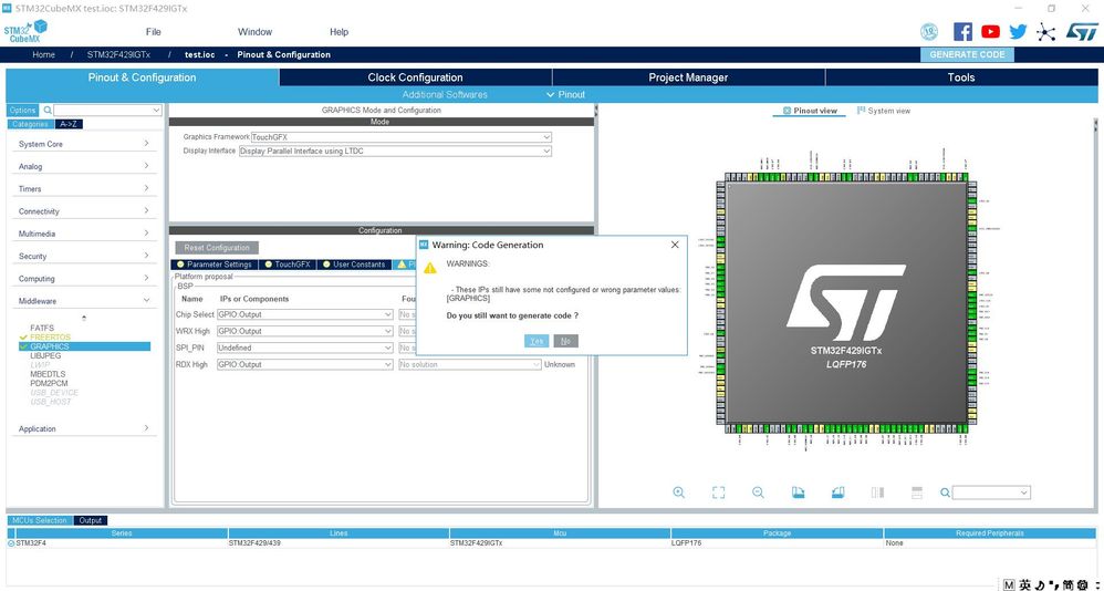

13 Click GENERATE CODE button and ignore the warning.
14 Waiting for the generating process complete the choose close.

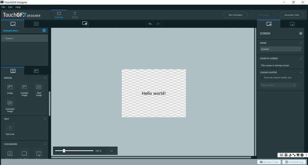

15 Click the Execute button to open TouchGFX Designer since it can be use after code generation.

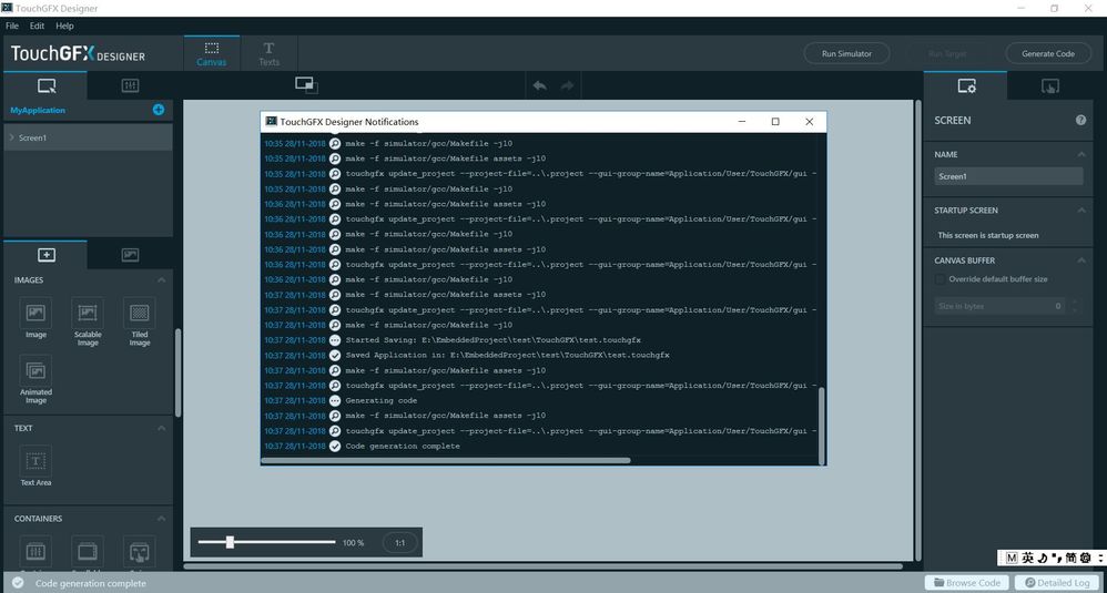

16 Drag a image and type a text in the TouchGFX Designer.
17 Clicke the Generate Code Button in the TouchGFX Designer. And then the status bar mention the process is complete.

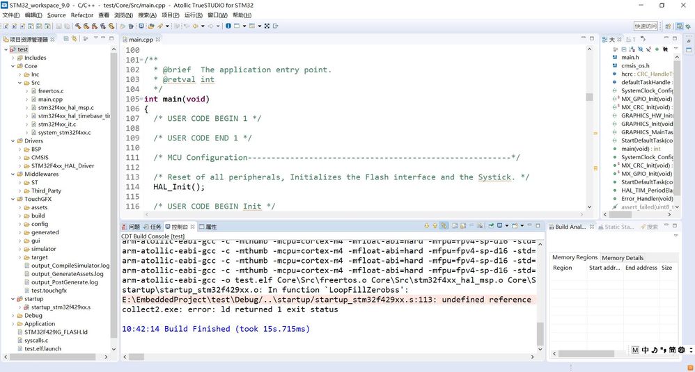

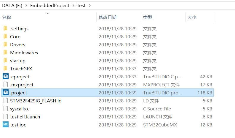

18 Open the Project file.
19 Try to build the project. And the same error shows.

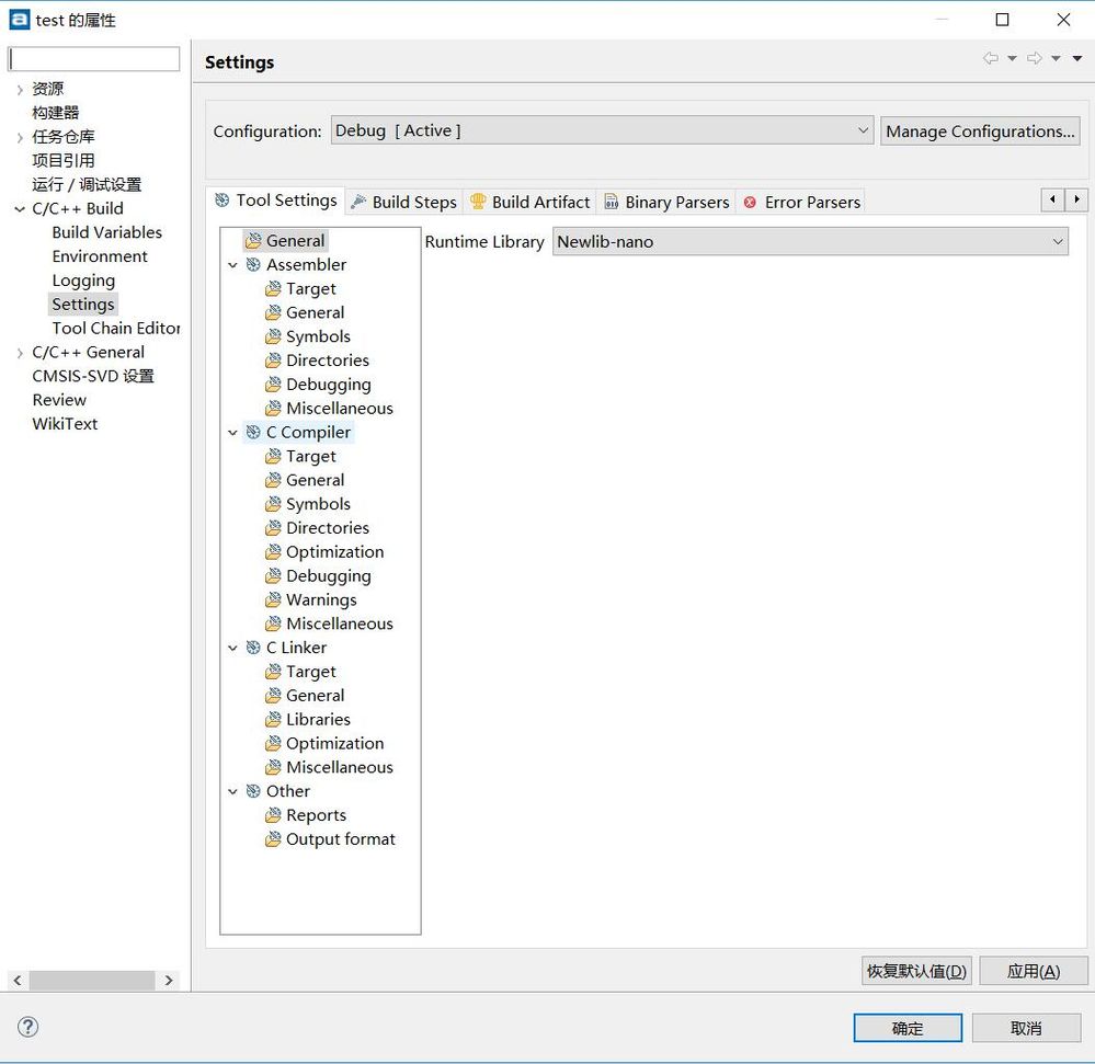

20 The C++ Compiler and C++ Linker didn't come out.
The whole project and screen shot are attached.
