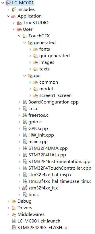

1. When opened the project, there were *.c , *.cpp , *.h and *.hpp files. But in C/C++ Build - Tool Setting , neither C++ Compiler and C++ Linker existed. So if I build the project under this settings, I will get a link error say something like main function undefined. Because main function is in main.cpp file and wound't be compile by GCC like other cpp files.
2. So I converted the project to C++ project, by using File - New - Convert to a C/C++ Project (Adds C/C++ nature) method. Now the C++ Compiler showed up and C++ Linker replaced C Linker.I built the project again, but a ton of error message like head files couldn't find show up. I fixed by copied and changed include path from C compiler directories to C++ compiler.But things not go well,some directories in Project Resources Manager's Includes still in grey which implicate those directories did not exist in that location.

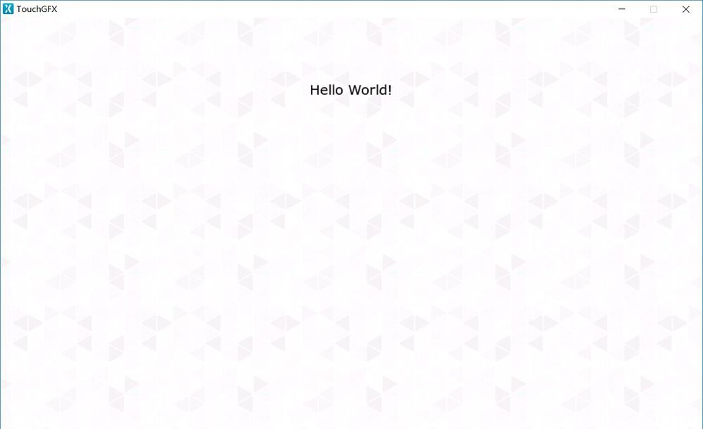

3. Then I use TouchGFX Designer to generated a simple project which is only contains a single screen of a text and a background image.After code generation, I put the entire folder in TrueSTUDIO project's root. Now the "Includes" didn't has grey directories any more.I dragged all the cpp files which is generated by TouchGFX Designer into TrueSTUDIO project path [Application-User-TouchGFX-generated|gui].Things going in here is a bit out of my ability, since I am new in TouchGFX and new in mixin C(GCC) and C++(G++) code together.

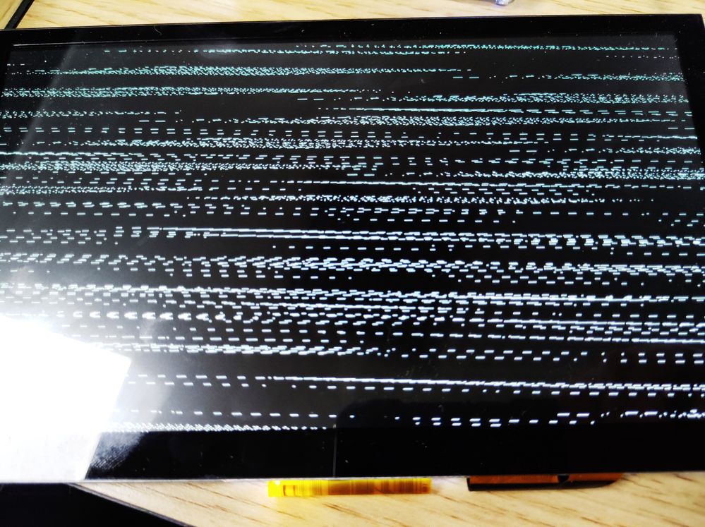

7. I download the program in my board. Sadly, I got this.

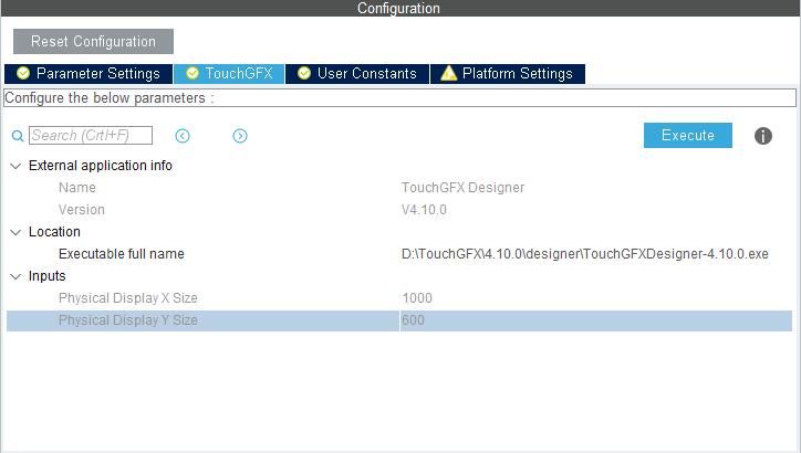

3.Then I linked the designer to GRAPHICS Configuration as the snapshot below.

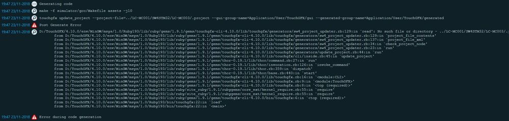

4.If the code never been generated, the "Execute" button won't be able to click.That is another difference between with tutorial. So I just click the button, and move to Step 4. After some simple design, I encounter an error of code generation.

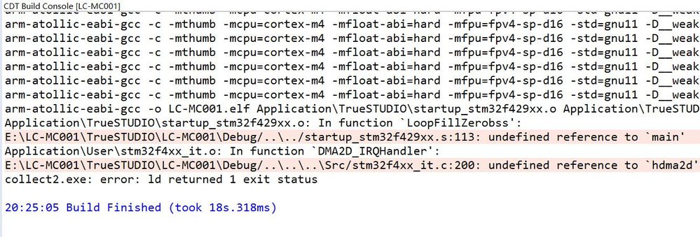

When I build now, I am getting three errors:
Description Resource Path Location Type
undefined reference to `hdma2d' stm32f7xx_it.c /TouchGFX_Test_Atollic/Core/Src line 230 C/C++ Problem
undefined reference to `hltdc' stm32f7xx_it.c /TouchGFX_Test_Atollic/Core/Src line 216 C/C++ Problem
undefined reference to `main' startup_stm32f746xx.s /TouchGFX_Test_Atollic/startup line 113 C/C++ Problem

In my opinion, the CubeMX did not turn on the C++ compiler (G++) for you, so your IDE won't compile files which have cpp suffix.Including the main function which is wrote in main.cpp.
After all c files are compiler by GCC, the process move on and go to the link stage. Then the start file couldn't found main function and reported an error.
You can turn on C++ compiler by your own to fix this problem but more will come after.:grinning_face_with_sweat:
