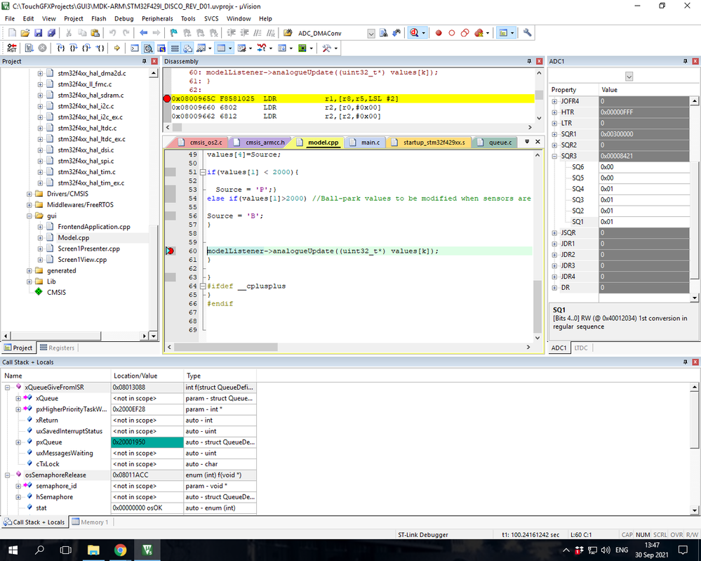

:beaming_face_with_smiling_eyes: I am familiar with the debugger tool ( to an extent).
This is what I see regarding the registers:

2021-09-30 4:50 AM
Sorry about the image, here it is

By Revision I am not too sure where to find this out. I chose the Discovery D01 board in TouchGFX. I have tried stepping - if I may ask what are the things I should look for during the stepping?
