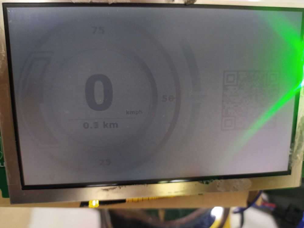

Hello, I am using STM32F746 with FMC SDRAM, QSPI flash, DMA2D. I observed my display is flicking. You can check video using below link.
https://drive.google.com/file/d/1j3uyyHWHlFO-fGW23RI33Iyos6meYaB-/view?usp=sharing
Any suggestions for solving this issue.

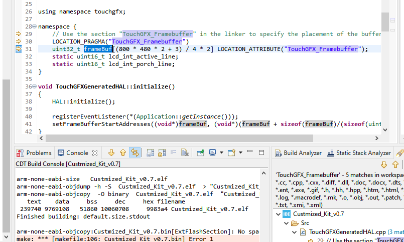

Also frameBuf, It should got to external RAM so i create a session in linker and place it like below:
MEMORY
RAM (xrw) : ORIGIN = 0x20000000, LENGTH = 320K
FLASH (rx) : ORIGIN = 0x8000000, LENGTH = 1024K
EXRAM (rx) : ORIGIN = 0x20000000, LENGTH = 8M
ExtFlashSection :
. = ALIGN(4);
*(TouchGFX_Framebuffer TouchGFX_Framebuffer.*)
. = ALIGN(4);
} >EXRAM
but also this big wouldn't fit in 8MB. Something seems wrong. I am using RGB565.

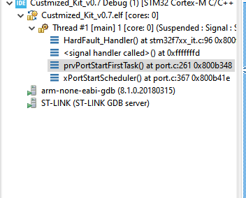

@Alexandre RENOUX
Hello, I am testing the code but now its going for hard fault post prvPortStartFirstTask().
I checked fault register CFSR value, its 0x400.
Thanks

@Alexandre RENOUX @EEuge
I successfully updated to latest version but still display only get hanged like above image after soometimes, STM is working fine. When I Reset disp pin of display (out of 40 pin) , display starts working again.
Any suggestions from your side?
2021-01-06 6:08 PM
If you based yourself upon the F746-DISCO Application Template and when debugging, the STM is working correctly while the display freezes, then maybe the problem is your display. In this case, you need to contact the display provider because this is outside the scope of ST.
/Alexandre
