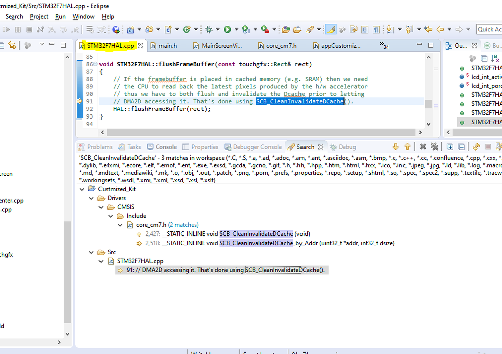

I believe it's related to the DMA2D. First check your MPU settings.
Also uncomment all the lines where you have SCB_CleanInvalidateDCache(); (They should be located in STM32DMA.cpp and TouchGFXHAL.cpp).

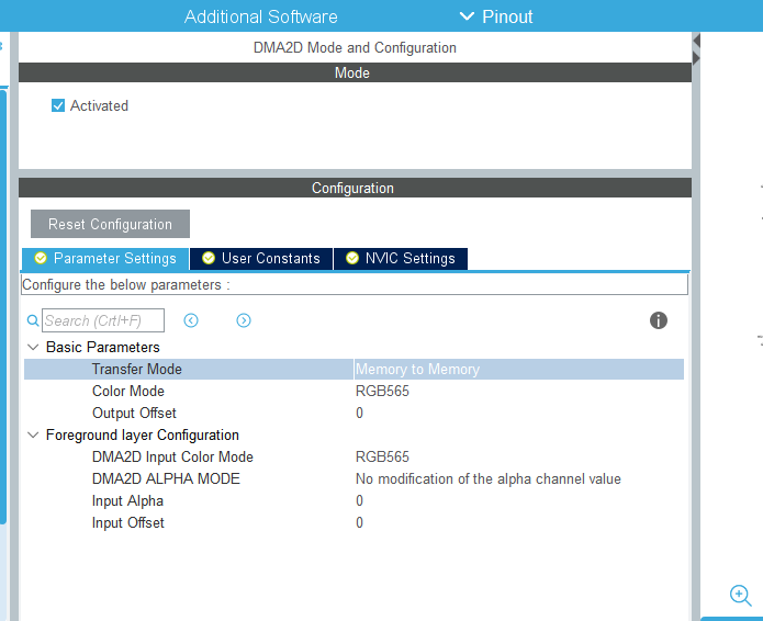

@Alexandre RENOUX Hi, I am using custom board with MCU 746 with below software with version :
Below are the settings for DMA2D
In My project, I searched for SCB_CleanInvalidateDCache(), but I am not directly calling it anywhere.

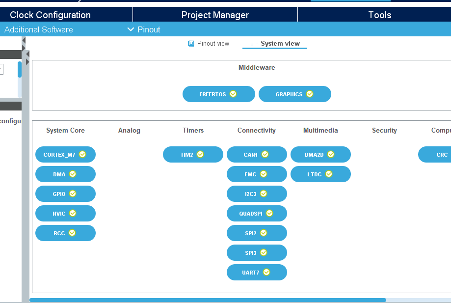

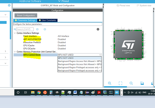

I didn't enable MPU. Check my system view.
2021-01-04 9:30 PM
MPU needs to be enabled. Please refer to the Application Template F746-DISCO available in TouchGFX Designer.
/Alexandre
2021-01-04 9:38 PM
Which MPU setting should I choose? Also I enabled DMA2D but below ART accelerator is disabled. Is this fine?
