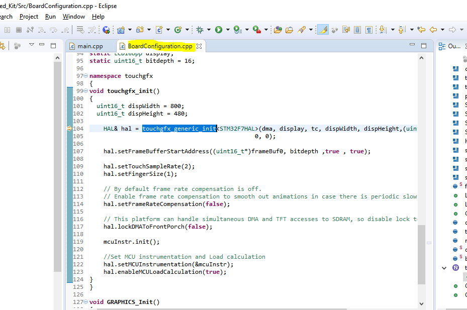

I think its changed in touchgfx 4.15 . I can see below function in boardconfiguration.cpp.
2021-01-04 10:23 PM
You are using the old way, please update to CubeMX 6.0.1, TouchGFX 4.15.
And look at the Application Template F746-DISCO.
/Alexandre
2021-01-04 10:25 PM
@Alexandre RENOUX Ok I am updating.
2021-01-04 10:30 PM
Look!!!!
You have
lockDMAToFrontPorch(false);set it to true!
This is bug of new version of CubeMX - this line is not written in the generated code. I have to write it manually every time I update the Cube project. I wrote here about this to the developers.

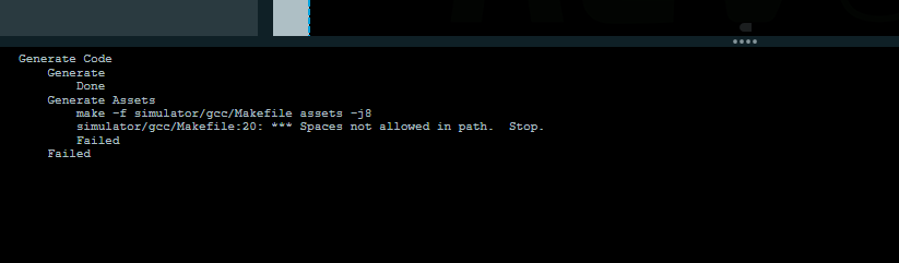

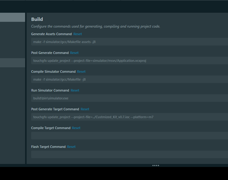

@Alexandre RENOUX I updated cubemx and toughgfx 4.16, But i m facing one issue while generating code.
My project path is D:\Color Dev\__CustmizedKitBootloader\Custmized_Kit_v0.7 and previously same path was fine with toughfx 4.15.
