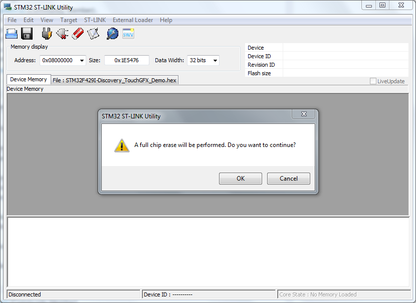

Try a full Chip Erase and see if that helps.
