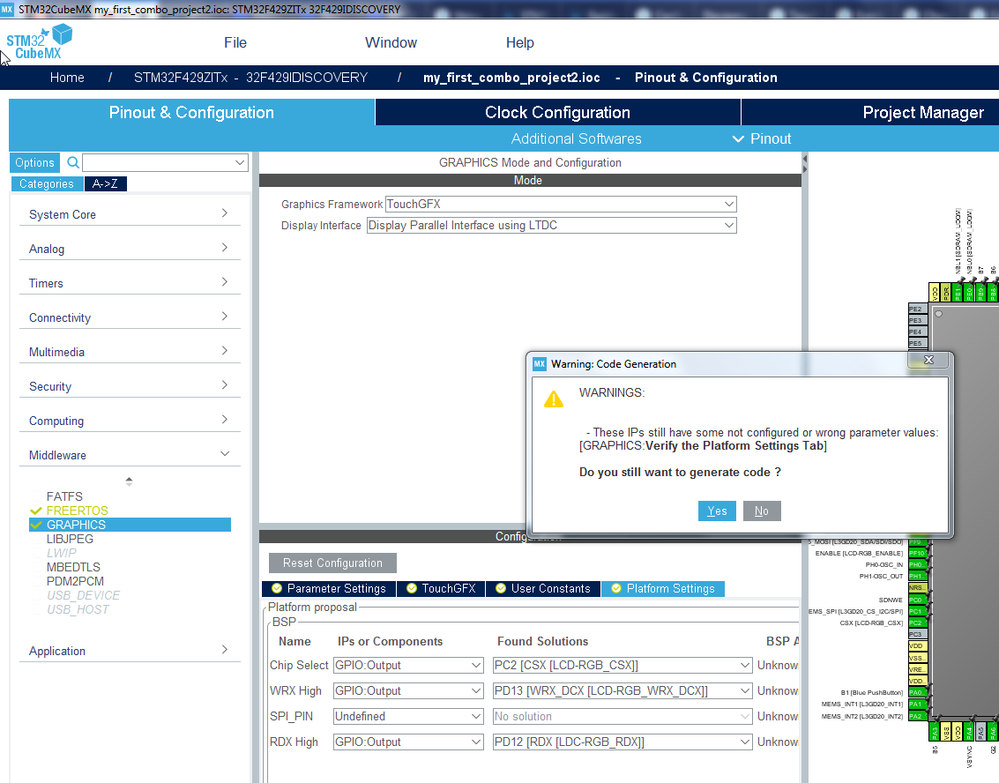

Hi. Here is the first draft document of the full procedure to support the STM32F429i-DISC1 target that we followed:
https://s3.amazonaws.com/axxonshare/my_combo_tutorial.zip
Welcome your feedback on the document and if it works for you. Good luck! :grinning_face:

2018-12-17 10:55 PM
Hi, @Mon2
Thank you for sharing this document, it resumes all step to build a project with TouchGFX and CubeMX... I have 2 questions :
Regards
2018-12-18 4:56 AM
Hi @elguezzar . Enabled the SPI pin to only relax the raised error / warning from the STM32CubeMX tool. Not sure if it is really required for operation as it appears that the ILI9341v controller onboard the TFT display is being configured using I2C. Can disable and still proceed to generate the code for testing upon reaching the office in a few hours. Based on the schematics for the STM32F429i-DISC1 kit, the PF9 = MOSI is used but may be our misunderstanding. Will experiment and write back with the updates.
The use of the USB is at your option. Do not believe there was any impact to leave this port function enabled. Once this package is operational, you are free to enable / disable ports of your choice using the powerful CubeMX tool to generate most of your code. To be honest, without such tools, not worthwhile to even consider the ST line as there is far too much low level code that is required to be operational.
