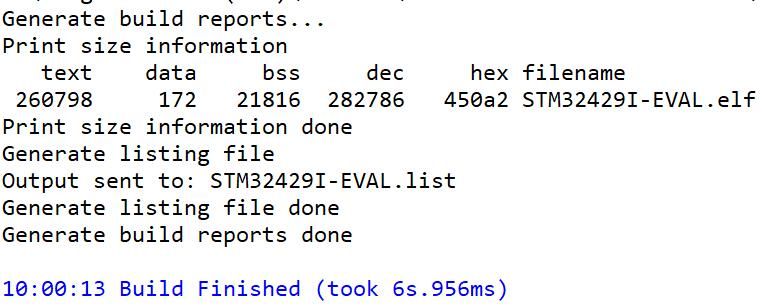

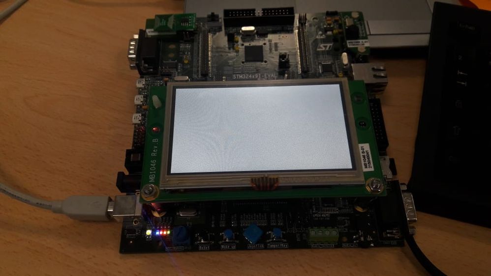

hi @Zhi Pang ,
i rebuilt your project in Atollic, i generated Hex file, and i flashed my Eval board but nothing displayed on LCD
2018-12-13 12:57 AM
Hi @elguezzar
I think the LTDC is not being initialized correctly.
In the project I offered, the MX_LCD_Init() function is located in \Application\User\TouchGFX\target\HW_Init.cpp.
You need to compare it with the official demo's LCD_Init() function which is located in \STM32Cube_FW_F4_V1.23.0\Projects\STM324x9I_EVAL\Demonstrations\TouchGFX\Gui\target\BoardConfiguration.cpp.
Since I don't have a EVAL board, I can't verify the project if it is fully functional or not for you.

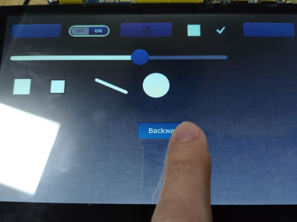

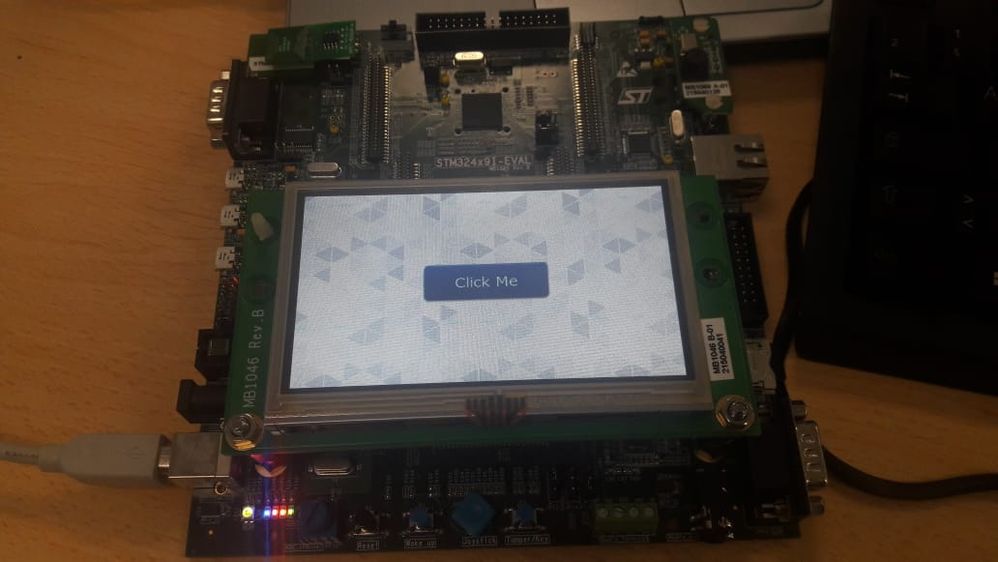

@Zhi Pang
Exactly...
I changed LTDC, FMC, and DMA2D configuration according to desmonstation on STM32Cube_FW_F4_V1.23.0.
Now i can display my GUI on STM324x9I_EVAL board
Thank you for your support :)
