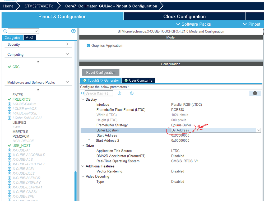

2023-05-30 10:17 PM - edited 2023-11-20 9:33 AM
After Doing all of the suggetion given above... still i was getting Flash over flow errors.... then i checked my CubeMX Configuration throughly and found that ... In touchGFx middelware section , i have selected Buffer location as "By allocation" ..... So i changed it and selected "By address" so my errors gone.
no errors coming when im not using any background image ... but when im adding background image ... im getting flash over flow error again...
