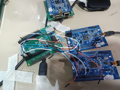

my observation: I took two STM32F407VGT6 microcontrollers and connect them the to same SDIO source it(setup) is not working when both boards are powered on but when USB and FATFS works fine seperatly the problem is in two pins (PC10 and PC11) D2 & D3 please give me solution for the following:
I am still facing issues in my project. I want to use USB functionality, but I am unable to do so due to a problem with SDIO pins PC10 (SDIO_D2) and PC11 (SDIO_D3). I am trying to connect two STM32F407VGT6 microcontrollers with the SDIO pins of the same discovery board (DM-STF4BB). We have uploaded USB (device-Mass storage device) code in one microcontroller, but that code only works when PC10 and PC11 pins are not shorted/connected. It doesn't matter if the second board is powered or not; connecting these two pins will always create a problem. And I want design a PCB in which only single controller will be powered at a time please guide me what to do, we can not use shottkey diode in PC 10&11 and VCC because of voltage loss, will MOSFET work ?

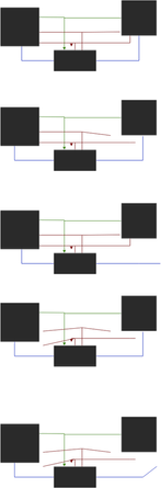

Consider the two red lines as PC10 and PC11 (D2 and D3 respectively), green lines as other SDIO lines with ground, and blue lines as VCC. Two squares represent STM32F4, and the rectangle below represents the SDIO device with an SD card.
code is uploaded in first STM32 on the left side
USB and FATFS functionality will only work in the following configuration
where as the USB will not even detect by any of the following configurations:

>>I have tried it posting on different- different forums like Stack overflow, ST Community forum, Quora and many more but still I am waiting for my issue to be resolved please help me out !!
And you've already opened a dozen threads here on this same project, with little interest. Pick one, and please don't open any more.
Perhaps you need more fonts and colours? Or some other engineers on the team.
Trying to share an SD Card between two boards seems like a bad plan. Why can't you have FAT-FS and USB-MSC work on a single board?
Concurrent usage is problematic due to coherency issues with the Windows system wanting to cache. One devices would need to own the resource, deferring the other with either Busy or Media Changed. Likely being in either Logging Mode, or being in On-load / Off-load mode to a PC.
Transferring files, via USART between two systems, probably want a protocol, people have been doing it for decades, perhaps review a couple of examples that worked. Jamming a continuous stream over the cable is not the answer / approach.
Your project as it stands looks to be an unworkable train wreck.
