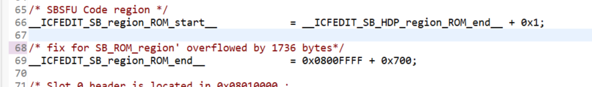

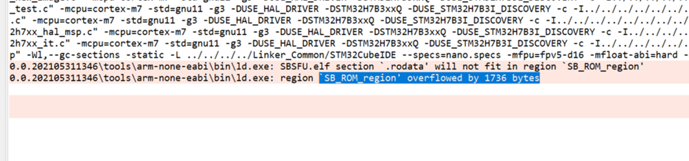

Then started building projects, run into overflow error
Fixed it by referring to section 6.2 Memory mapping adaptation

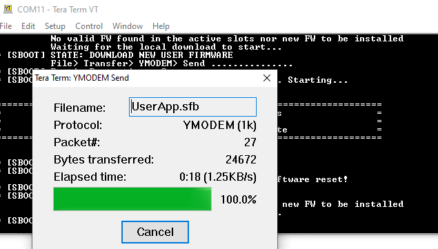

4.Now SBSFU is programmed to board using STM32CubeProgrammer
5.User application is send using tera term with
Baud rate = 115200
- Data = 8 bits
- Parity = none
- Stop = 1 bit
- Flow control = none

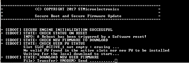

6 SBSFU executing
7 User application send to device
Now instead of actually jumping to application SBSFU is still waiting for UserApp :pensive_face:

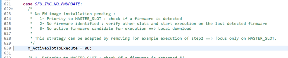

In sfu_boot.c control is returning from
Hoping to get some pointer on what is going wrong in system.
Thanks

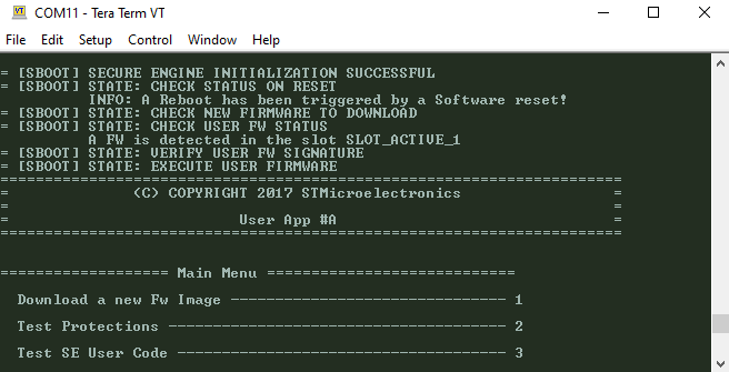

2021-12-20 9:54 AM
Thanks @Jocelyn RICARD for detailed and complete instructions on
:thumbs_up:
BL is transferring control to application code
