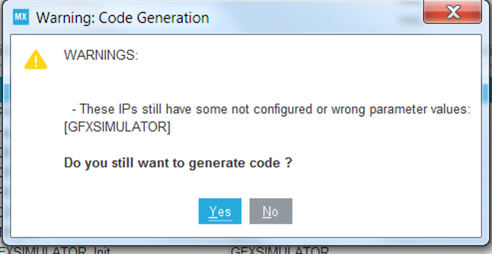

How do you get around this error?
This occurs when Generate Code within CubeMX 5.1.0

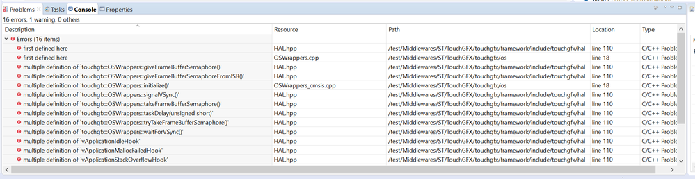

I am having similar problems.
Should there be a separate TouchGFX distribution which doesn't include the simulator stuff, for CubeMX use ?
I installed TouchGFX separately, first, and then CubeMX, but I'm having all these same problems.
and after removing the simulator and sdl stuff myself, I have different problems:
2019-04-26 2:12 PM
@Martin KJELDSEN disabling rtti did it for me, thanks!
