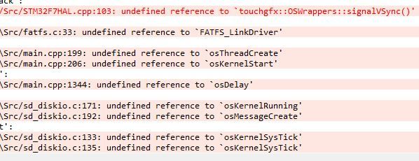

Now for example I have a lot of errors "undefined reference to", like:
Src/main.cpp:199: undefined reference to `osThreadCreate'
Src/STM32F7HAL.cpp:103: undefined reference to `touchgfx::OSWrappers::signalVSync()'
Regards.

Hi @Martin KJELDSEN ,
Thanks for the support! The MX_FreeRTOS_Init() error I could fix I think with the simulator folders (it was a lot of changes until now!), so with the last RTTI I'm at this point:
For example for "undefined reference to `osThreadCreate'" the file is in the project and the path is declared in project options too.
Regards.
