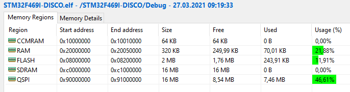

So to my understanding it simply "refuses" to flash the QSPI... yet when taking a look at the build analyzer it looks like this on both laptop and PC:

Can you confirm that your linker script looks similar to below?
/* Memories definition */
MEMORY
CCMRAM (xrw) : ORIGIN = 0x10000000, LENGTH = 64K
RAM (xrw) : ORIGIN = 0x20000000, LENGTH = 320K
FLASH (rx) : ORIGIN = 0x8000000, LENGTH = 2048K
SDRAM (rw) : ORIGIN = 0xC0000000, LENGTH = 16M
QSPI (r) : ORIGIN = 0x90000000, LENGTH = 16M
}If you download STM32CubeProgrammer standalone, are you able to browse memory location of QSPI after selecting the appropriate external loader? (You can find the external loader selected under Debug Configurations -> Debugger tab, Misc section)

Yes the linker script looks as above, yet I have found my solution. I reinstalled CubeIDE and when opening my .cproject file I make sure to have CubeIDE closed. I dont know which of these caused the board to flash normally but it works.
