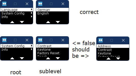

2023-01-25 3:58 AM
:D ok
In braces this is the item index
Menu level
(0) Language
-(0) German
-(1) English
(1)System Config
-(0) Address
-(1) Contrast
-(2) Keytone
- (3) factory reset
- etc etc
(2)Info
-(0) Hardware
-(1)Firmware
i added some screenshots
this is all done in the same scrollwheel.
When i enter the submenu of "system config" i would expect i land at "address" but i don't because "system config" was itemIndex 1 and when i reinitialize/invalidate the scroolwheel it somehow starts to update with itemIndex 1.
when i go into submenu of "Info" which is itemIndex 2 i would expect to go to "Hardware" but i go to a non existing itemIndex becaue it starts the update with itemIndex 2
So my methods
void MenuLevel1View::scrollWheel1UpdateItem(menuItemNormal& item, int16_t itemIndex)
void MenuLevel1View::scrollWheel1UpdateCenterItem(menuItemSelected& item, int16_t itemIndex)are called with wrong itemIndex
When i invalidate or initialize the scrollwheel i would expect it starts to redraw with itemIndex 0 which it somehow does not
Is this clearer explained?

2023-01-26 4:55 AM
Hey again,
I analyzed your project quickly, and I think the issue comes from the fact that you are using only one ScrollWheel object in all your application, and so when you navigate to the second item of your first view "System Config", the item index will be set to one.
Then, when you switch to the sub-wheel, it will animate automatically to the item number 1 of your wheel, so it will go to "Contrast" rather than the first element "Address". I deduct from that that the initialize() method does not reset the current item index to 0.
I would recommend you to use the animateToItem(0, 0) like you did, it is a good way to ensure that the sub-wheel start at the first index.
/Yoann
