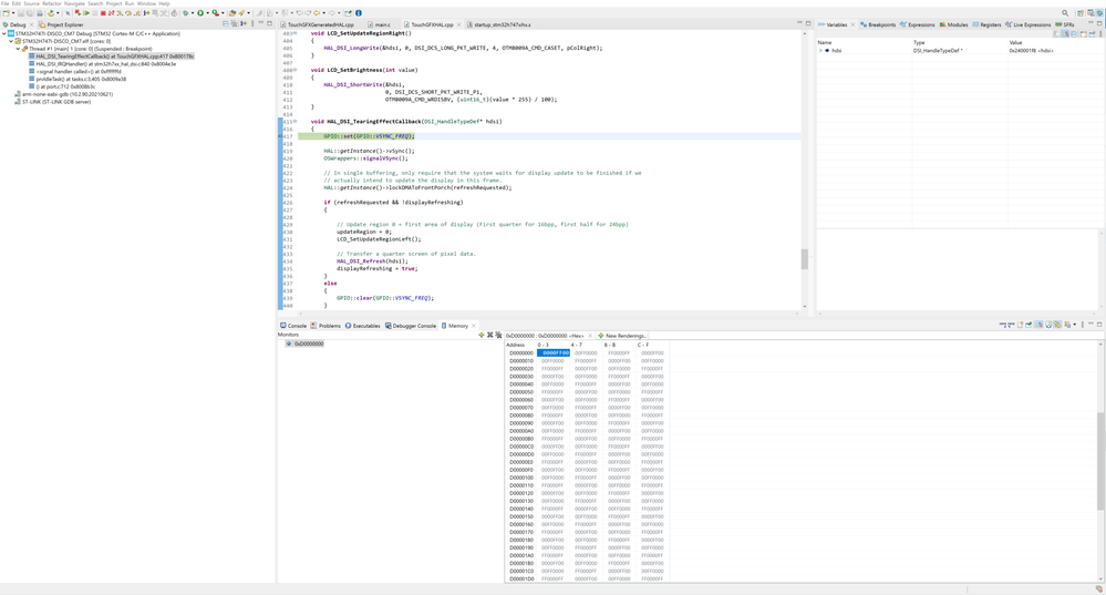

I got the STM32H747I-DISCO Discovery kit, and I made screen with just two buttons. On the gfx simulator, everything is fine, but as you can see on attached picture, on the real LCD I see so many error pixels both around the buttons, and diagonally. I suspect it is in the setting of the LCD in the Cube ide. The datasheet for the LCD lacks HW details(Horizontal/Vertical Front/Back Porch, VSync/HSync Width etc.), so I am using the defaults.
It also maybe the LCD clock. It is set now at 38MHz. Not sure what is the correct clk setting.
If anyone have any idea, please let me know.
PS: I am using Touchgfx 4.19.0, and Cube ide 1.9.0
Thanks.

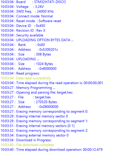

2022-03-25 5:38 AM
I do not know why it takes you just 12 seconds to flash your board.
