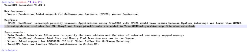

Hello @Jnevi.1,
Sorry we apparently forgot to answer your post some months ago.
Indeed, this bug was fixed in 4.21.0, you can see it if you open the .pdsc inside the X-CUBE-TouchGFX installation repository :
/Yoann
/Yoann
